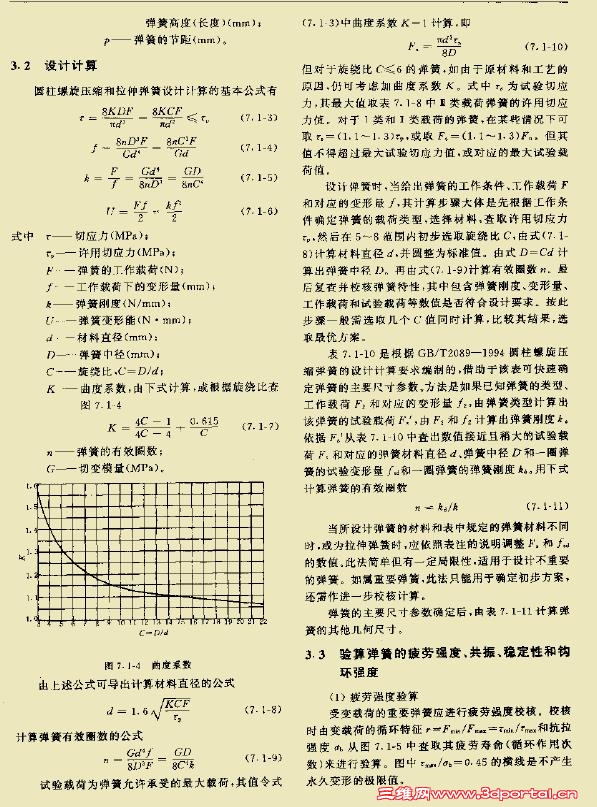

楼主解决了吗?我也有个弹簧计算图你看看有用吗?
发表于 2010-7-21 13:32:19 | 显示全部楼层 来自: 新加坡
Please refer to the desgin procedure.
% F% X, x5 n5 K; l% q8 hIt is easy to follow.
