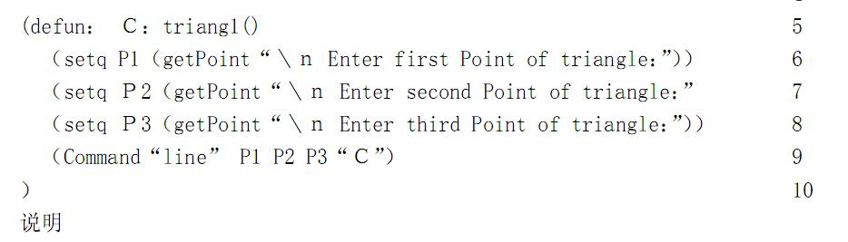

  g3 M4 w* p6 c为什么我照着教程编写的LSP程序,老是提示输入中的点位置不正确。
! k& t" ^4 S" T8 u3 D这个是照着教程自己写的源码:/ d5 ?% f% g- t2 U5 X) {5 ]
;this program will prompt you to enter three points                 ; m$ r0 B2 B5 A0 S. s: D4 V/ r3 ?
;of a triangle from the keyboard ,or select three points; a1 r, S: k" ?, H6 S/ p
;by using the screen cursor .P1,P2,P3 are triangle corners
( Y1 L9 B3 j/ d
: I  n& D" F  \6 p6 n/ _(defun: C:triang1(); y4 S$ @. S9 s% f- G( c
  (setq p1(getPoint“\n Enter first Point of triangle:”))! [4 s( s; K3 r9 P& W9 E- h
  (setq p2(getPoint“\n Enter second Point of triangle:”))) @7 t4 t. r: M% K; L+ M
  (setq p3(getPoint“\n Enter third Point of triangle:”))
1 [3 S8 [5 ]6 \- ?+ O- {& o+ ^9 d  (Command“line” p1 p2 p3“C”)
4 _" p. T& F& w9 N; S( q/ s! t
- r* ?; W, p6 x教程为下面的图片

混用了全形...
2 x% Q( X: Y- k. M: P5 u/ J4 @( u==========================2 g: i3 R' V4 \
(defun c:triang1 ()/ f6 b5 G% N8 m/ v& v( x3 A
  (setq p1(getPoint "\n Enter first Point of triangle:"))- [5 A1 L/ I! L  @% n
  (setq p2(getPoint "\n Enter second Point of triangle:")). ?7 F3 D, W, D: k, M( ]: t; H
  (setq p3(getPoint "\n Enter third Point of triangle:"))9 w, [. r8 W8 [3 P! N6 O5 R; t. b
  (Command "line" p1 p2 p3 "C")' s# H7 }# l# {5 K( u2 c

难道是因为(defun: C:triang1() 这里的问题么,能讲的详细点么,我是搞接触新手,不大会啊

SunVei网友是台湾人,他用的名词和大陆不太一样,呵呵.他是说你混用了全角字符./ L6 g3 k/ e3 ?- w1 [2 ~
你的代码中除第一行以外,其它几行的括号、双引号和反斜杠都是用的全角字符,这不对.应该用半角的,也就是英文的.
