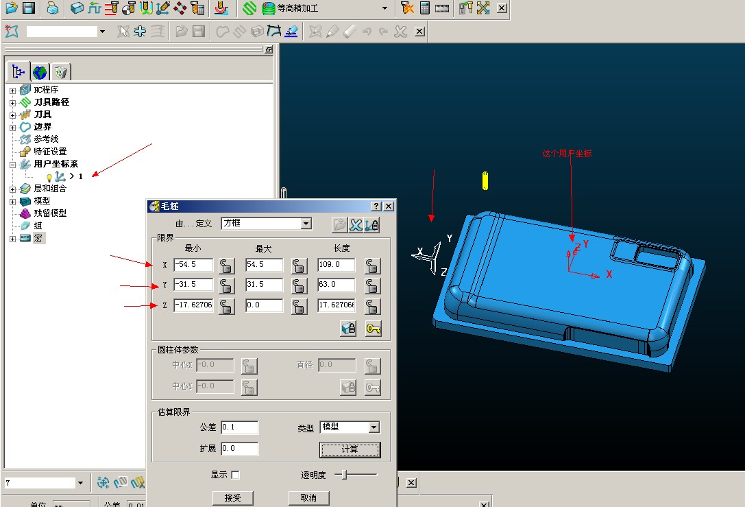

发表于 2009-4-23 09:52:58 | 显示全部楼层 来自: 中国广东珠海
请看图片!~~~~~

 楼主| 发表于 2009-4-23 11:25:40 | 显示全部楼层 来自: 中国上海
回复 22# 00000041 的帖子
图形初始状态 电极头部向下. R) O# _, _' b& ^* N
/ O& S' S1 D; J. z& b//qq38703766! H6 w$ V1 x7 b9 r* K0 ]
DEACTIVATE WORKPLANE  U; J9 @( l) R
FORM BLOCK( ]/ Y( Q. b4 I% b0 |4 y
UNDRAW BLOCK
# [) P, C% O0 ]4 B" i# ]EDIT BLOCK ALL UNLOCK$ J1 S: q) S' ?9 b& w0 C
EDIT BLOCKTYPE BOX* D1 U% S2 Q' W6 S# M3 ]4 g( U& Z
EDIT BLOCK TOLERANCE 0.01$ N# Y' ~5 c0 q" N  K5 L9 b% t
EDIT BLOCK LIMITTYPE MODEL
+ {* ^2 z" t, T' K; G$ l7 K! k4 Y. ?EDIT BLOCK RESETLIMIT 0
% e2 U* u2 n. ^- [( w" N% ?1 C% hEDIT BLOCK RESET
) }0 [) t7 V4 {$ H$ T9 T8 XEDIT BLOCK XMIN LOCK# m; y- ~5 N1 X+ z
EDIT BLOCK XMAX LOCK& I1 E  O3 T# r
EDIT BLOCK YMIN LOCK' N/ C- S/ ~8 Y: Q
EDIT BLOCK YMAX LOCK" }$ ?9 I3 h9 }) b' `1 f
EDIT BLOCK ZMIN LOCK2 u2 x* l8 u7 N( {) ~
EDIT BLOCK ZMAX LOCK
  b# r, X- X$ a. U( z9 p. jBLOCK ACCEPT
4 M; b& F- T0 f7 m0 c$ qDELETE WORKPLANE "UserWorkplane"
: N. z* U8 u0 y# ]2 e* RCREATE WORKPLANE "UserWorkplane" YES FORM WPEDIT$ U; I2 L% p; t) `% s8 F
EDIT WORKPLANE "UserWorkplane" X "(Block.Limits.XMax-Block.Limits.XMin)/2+Block.Limits.XMin"$ ?+ a7 {; I+ N) r# |& w* e
EDIT WORKPLANE "UserWorkplane" Y "(Block.Limits.YMax-Block.Limits.YMin)/2+Block.Limits.YMin"
/ g6 }6 _, Q; y$ A) i$ B8 S8 wEDIT WORKPLANE "UserWorkplane" Z "Block.Limits.ZMin-0.15"5 s' t3 p; j, g- }5 y8 y* W4 W
TRANSFORM MOVE "0"
; {1 i1 I  ?' Z% Z) S$ f  q# mTRANSFORM ANGLE "0"
6 Z+ v/ z4 f. O* ^" C# L! VWPEDIT ACCEPT
% n6 |1 j$ B6 N+ sACTIVATE WORKPLANE "UserWorkplane"6 {6 b" a5 f/ A" S
FORM BLOCK2 }5 h( I- U- B0 _1 f. k
UNDRAW BLOCK
  V# b3 w/ p/ w' k& @& K" eEDIT BLOCK ALL UNLOCK5 A% n5 l" `8 f6 k8 \( L- K
EDIT BLOCKTYPE BOX9 @+ z" w$ l: @/ r; }$ X
EDIT BLOCK TOLERANCE 0.01! n& S" T$ M3 |. l
EDIT BLOCK LIMITTYPE MODEL5 k/ W0 _) L+ P8 Z6 t/ w7 ~0 D' d
5 [0 n" p2 U9 s8 A1 q) ~7 B. y' hEDIT BLOCK RESET
8 T! a0 z7 i5 y  R8 OEDIT BLOCK XMIN LOCK
1 O& f' ?8 E/ u8 F6 zEDIT BLOCK XMAX LOCK
: [; [. a% [" {$ }. A% zEDIT BLOCK YMIN LOCK
- S$ f& V9 {& AEDIT BLOCK YMAX LOCK
2 _/ H6 `) x+ Z/ F( y7 C3 IEDIT BLOCK ZMIN LOCK
( Q4 {! L. [. g& z6 oEDIT BLOCK ZMAX LOCK
+ j8 O/ {  {5 d2 m, fBLOCK ACCEPT
( u+ O, H3 y! {. oTRANSFORM ANGLE "180"4 w3 {- V8 T  |, H5 M0 p& w$ i
TRANSFORM TYPE ROTATEY TRANSFORM WORKPLANE "UserWorkplane"
; M: I. r/ A  k8 w$ E' xTRANSFORM ANGLE "(sign(Block.Limits.YMax-Block.Limits.XMax)+abs(sign(Block.Limits.YMax-Block.Limits.XMax)))*45"
& z1 M) S6 O5 aTRANSFORM TYPE ROTATEZ TRANSFORM WORKPLANE "UserWorkplane"' d. [* Z% |- f# m6 x! N
FORM BLOCK
" e) \9 k: j# S  PUNDRAW BLOCK6 \' S! y1 T- k0 p8 k
/ y3 B" k: }3 U8 ]' }1 Y5 a. X! k9 iDELETE BLOCK1 }* m, [# N- E! d8 B/ `! W5 P
BLOCK ACCEPT. C  t- Y" w3 Z; M- @
EDIT MODEL ALL SELECT ALL
" x2 l0 n% a) F" g  g1 w; mEDIT MODEL ALL ORIENT_NORMALS SELECTED
1 k+ F- {5 P6 ]/ Q) ]EDIT MODEL ALL REVERSE
1 N' b* S" m$ b7 oEDIT MODEL ALL DESELECT ALL7 V' B! D" S/ Z# x- I" H
ROTATE TRANSFORM ISO2 VIEWMILL RESIZEVIEW
0 V4 A& y& A1 x9 U3 {$ s$ X
* N8 w0 E5 g" N9 b: Z[ 本帖最后由 WHT44 于 2009-4-23 11:27 编辑 ]
