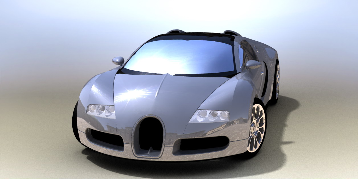

未免遭喷,上个老作品,估计有人见过,就是无聊的在下玩票之作了~sw08,渲染PW

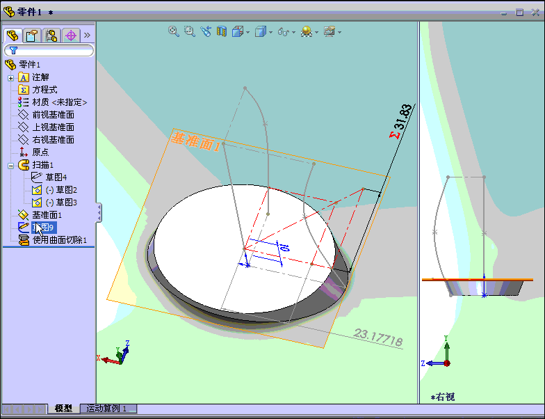

这种治学的态度真是不可理喻……那么请看看明白
  c" F& o, ^7 T4 h7 u) v1.what i was doing
0 H6 l; o1 v1 k+ ?* a2 g2 E2.why and how3 C& j; s4 J" [8 ]# E, k
3.where does the deviation come from7 P- R+ D! B3 _9 i  Q

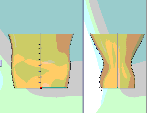

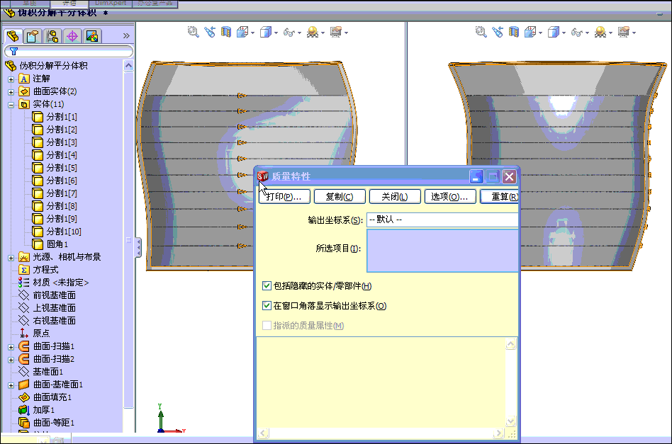

- ~& L6 F4 ]: @( B 伪积分.gif

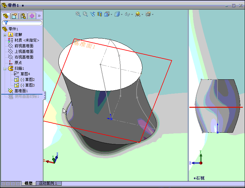

, g0 s1 O% C. tA simple test to check whether it can divide a random solid" E. s+ {$ R$ O; i
- p* |( s/ Z& R, o3 cBut still the deviations exist
