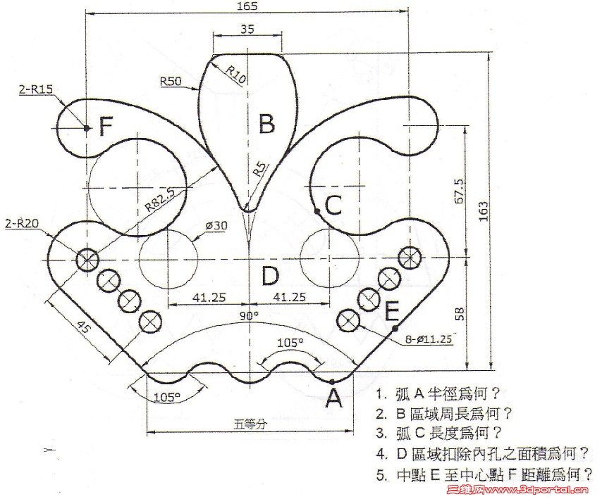

CA D几何作图竞赛题(2011年2月),至2月23日止9 p* S" B7 U0 g" e4 K) q7 p
# Q; V1 k0 \' r- {) N$ X& L一.竞赛题目(参见附图)
; v1 U1 w9 U& I4 W/ t0 ~/ ^9 W, J8 m- v  X3 w
基础综合练习38) T7 X* D# R* H) ?- E! [5 j0 c
9 H. u+ H' {: J' R1 r9 }' _/ _! i# e: F( @/ F/ C# X+ C4 {8 m0 i
用AutoCAD作图法求出该题要求的5个数值,5 k( D0 {* T0 n0 m2 {% ]
) M7 `9 d+ I$ k$ R. n
尺寸精度要求精确到小数点后4位。角度单位必须使用十进制度数,不得使用度/分/秒,百分度和弧度,精度也要求精确到小数点后4位。' j( w7 h$ O  _7 |" m# m

9 r' g  f* m* L4 `/ N$ T5 Q  K竞赛已结束,评分及奖励见下表.; D# X" R, K6 a3 ]
楼层用户名ABCDE正确数奖项加分
标准答案13.3066212.8395111.337316648.2194188.263
3zyyyyp13.3066212.8395111.337316648.2194188.2635一等奖30
4mountainsheep13.3066212.8395111.337315234.5027188.2634二等奖20
5D13.3066212.8395111.337316648.2194188.2635一等奖30
6xiaoyi94513.3066212.8395111.337316648.2194188.2635一等奖30
7LIAIYAO13.3066152.6943111.3373 188.2633三等奖10
8王老大先生13.3066212.8395111.337316648.2194188.2635一等奖30
9寂灭神伤13.3066212.8421111.337316648.219188.2633三等奖10
10林主059813.3066212.8395111.337316648.2194188.2635一等奖30
11yjhljh13.3066212.8395111.3373116648.2194188.2634二等奖20
12coolboy12313.3066212.8395111.337316648.2194188.2635一等奖30
13gerald_lee13.3066212.8395111.337316648.219188.2634二等奖20
14wheasy02713.3066212.8395109.875216734.1006188.2633三等奖10
15感悟人生13.3066212.8395111.337316648.2194188.2635一等奖30
17liushui30213.3066212.8395111.337316648.2194188.2635一等奖30
18laualfred13.3066212.8395111.337316648.2194188.2635一等奖30
20sduzxx14.9296212.8395111.337316635.104188.2633三等奖10
21lanbo913.3066203.9788111.3373 188.2633三等奖10
23mgame16813.3066212.8395111.337316648.2194188.2635一等奖30
25jastin16813.3066212.8395111.337316648.2194188.2635一等奖30
26月精靈13.3066212.88111.337316648.219188.2633三等奖10
27zhhayu13.3066212.8395111.337316648.2194188.2635一等奖30
28TIANSHE13.3066212.8395111.337316648.2194188.2635一等奖30
29zhaoyafei1913.3066212.8395111.337316648.219188.2634二等奖20
30百陌生13.3066215.1325111.337316648.2194188.2634二等奖20
31lxf32513.3066212.8395111.337316648.219188.2634二等奖20
33ugforrest13.3066212.8395111.337316648.2194188.2635一等奖30
35zhlq51813.3066212.8395111.337316648.2194157.21324二等奖20
36danielxp200413.3066212.8395111.337315234.5027188.2634二等奖20
37inuyasha_pw13.3066212.8395111.337316648.2194188.2635一等奖30
3812fzj13.3066212.8395111.337316648.219188.2634二等奖20
39ss98813.3066212.8395111.337316648.2194188.2635一等奖30
40wen_jg13.3066212.8395111.337316648.2194188.2635一等奖30
41SXFZGQYX13.3066212.8395111.337317443.435188.2634二等奖20
43皮卡丘200713.3066212.8395111.337316648.2194188.2635一等奖30
44yuansyou13.3066212.8395111.337316648.219188.2634二等奖20
45cbm945513.3066203.9789111.337316648.2194188.2634二等奖20
46liboloveg13.3066211.9296111.337316648.2194188.2634二等奖20
47liulanlan42213.3066211.9296111.337316648.2194188.2634二等奖20
48cclqdgv13.3066212.8395111.337315234.5027188.2634二等奖20
49houchedating13.3066211.9296111.337316648.2194188.2634二等奖20
50liliulaoda13.3066211.9296111.337316648.2194188.2634二等奖20
51chuhanshe13.3066210.228111.337316648.2194188.2634二等奖20
53老式面包13.3066209.5109111.337316585.7619188.2633三等奖10
54oscar.zl13.3066226.4963111.337316648.2194188.2634二等奖20
% G  D" s' Q& ~1 H
注:表中字体为红色者代表答案错误或不符合规则要求,空白者代表未提供答案或答案不明确.

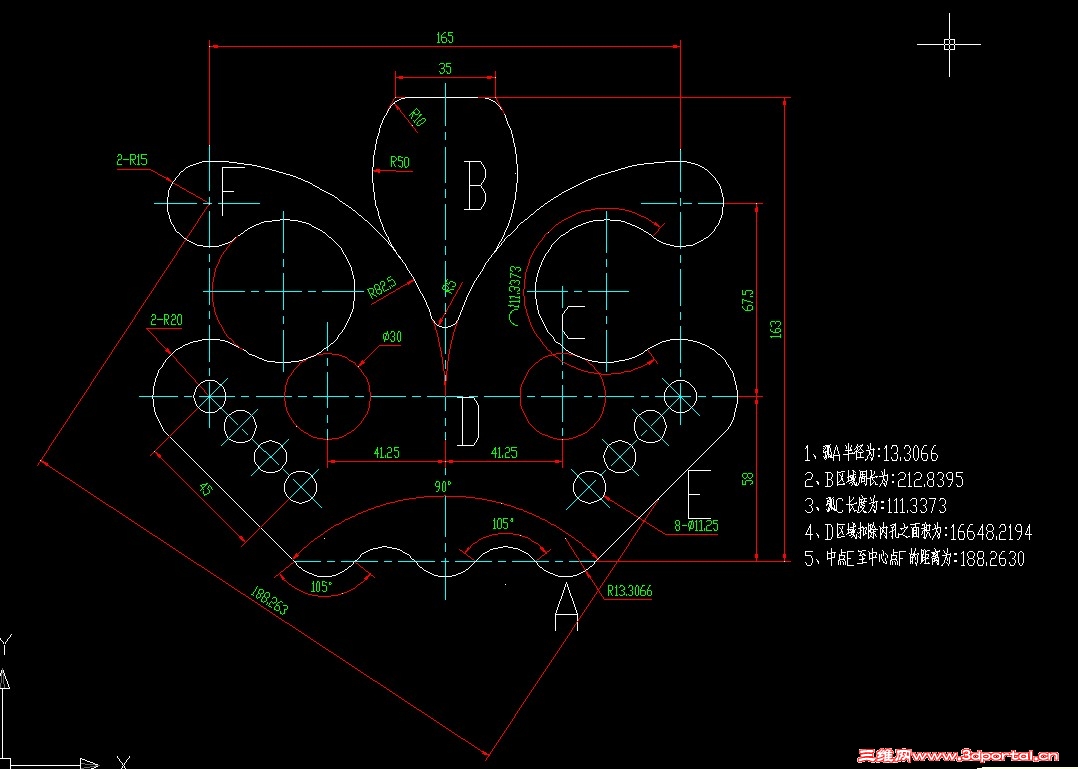

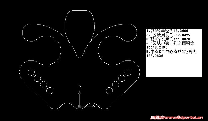

发表于 2011-2-15 13:45:24 | 显示全部楼层 来自: 中国上海
: l4 t3 d/ h# W$ P0 l  _+ i9 Q

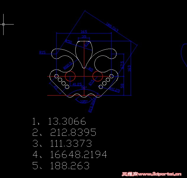

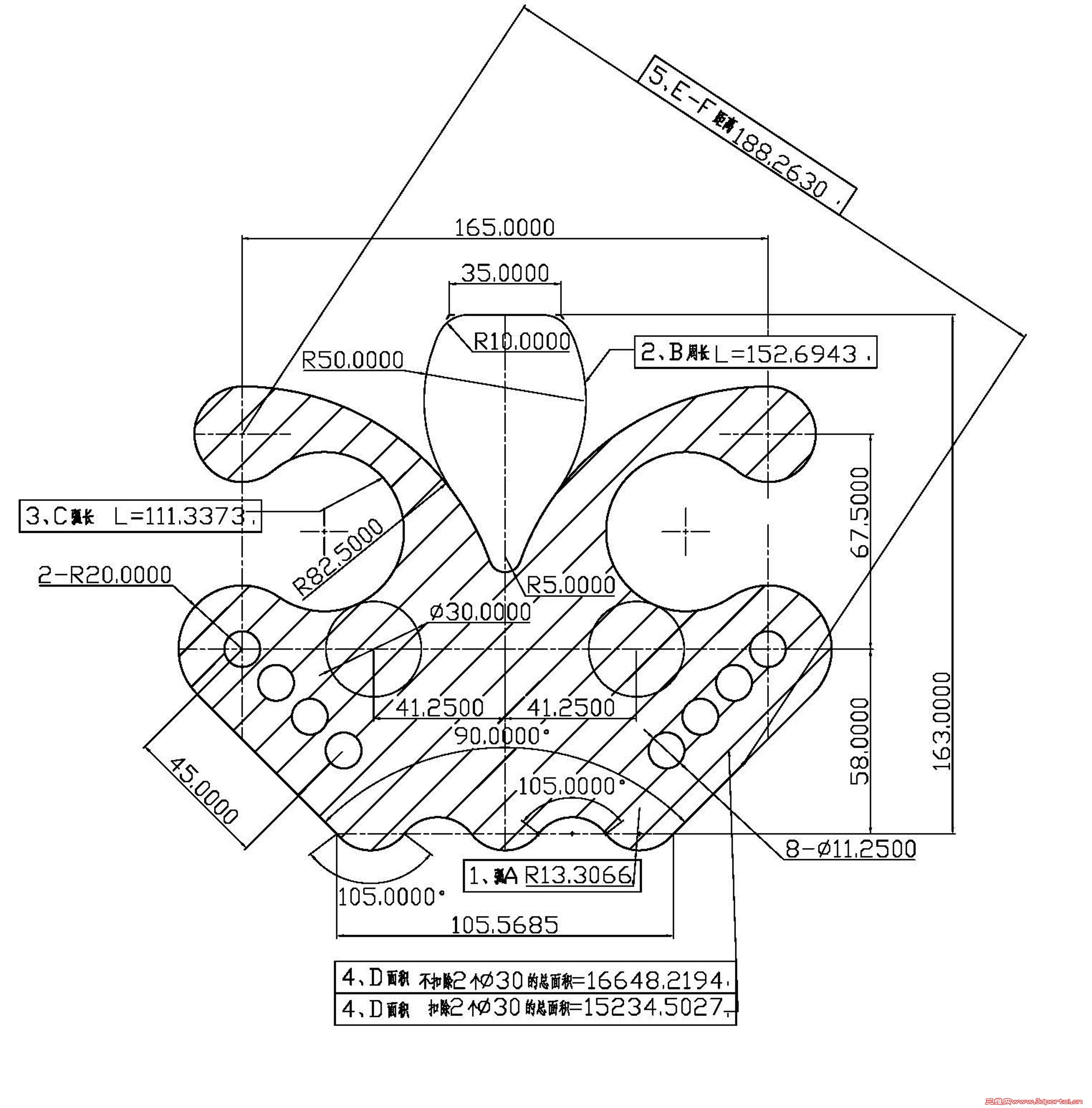

* P( e4 d$ t* S" L, R( w 11021501.jpg 沙发!交作业。
110215.wmf
19.76 KB, 下载次数: 5
参与人数 2三维币 +35 收起 理由
2005llnn + 30 完全正确,授予一等奖!祝贺!
woaishuijia + 5 参与鼓励

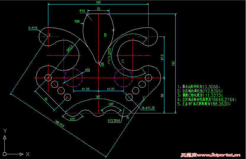

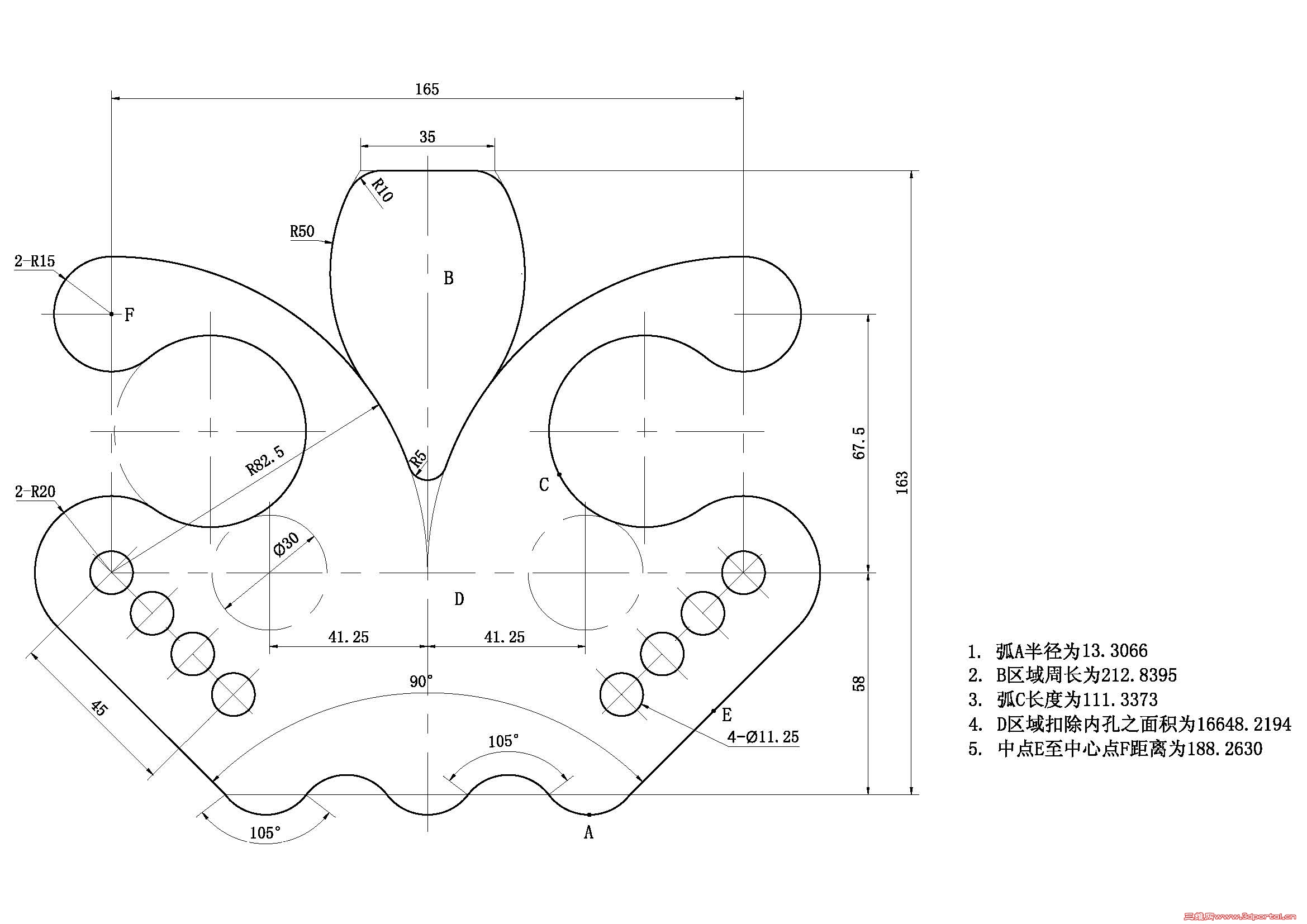

发表于 2011-2-15 15:26:16 | 显示全部楼层 来自: 中国内蒙古包头
3 c9 I$ A* u: }! w# J  F

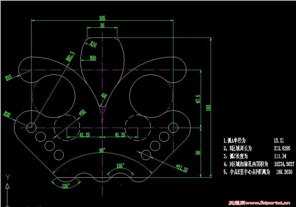

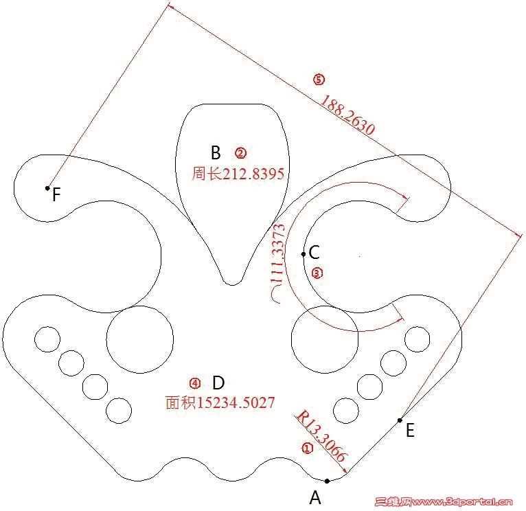

, n/ f* p/ i. e7 C/ @& S3 A上飞机前画个图
参与人数 2三维币 +25 收起 理由
2005llnn + 20 二等奖

2# 2005llnn ! l% R! c% l, L, W! \
请问 9 J. v7 u0 Y9 T% c2 G: t
那两个30的圆算内孔吗?1 k+ ~+ p. Y( z- d
还是辅助作图用?

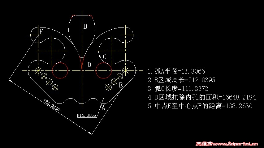

* k+ E* {; Y" l# b' d2 u 2011.2.JPG 交作业,挣点银子。
参与人数 2三维币 +25 收起 理由
2005llnn + 20 二等奖

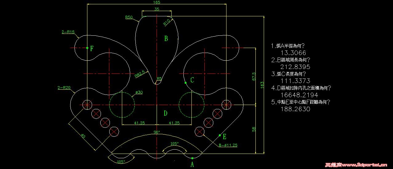

CA D几何作图竞赛题(2011年2月).jpg 我的练习

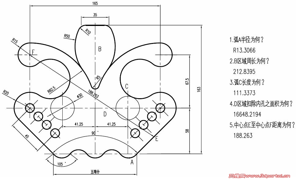

5 l' a+ m/ X2 h/ ~! Q" b参与练习
& T/ J) `) D) O7 z$ q# r( h% l% B1 A: a
20110216.jpg 7 [5 T  U% P* I7 a& M
2011年2月.dwg (77.38 KB, 下载次数: 2)
参与人数 2三维币 +35 收起 理由

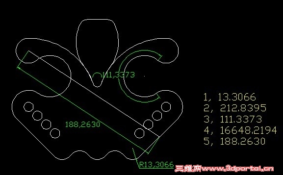

7 {9 B1 y( P2 L+ G, Z8 |% N) u参与一个
; \; g; K; u" L2 C/ V8 o4 k& `( [ 2011-2-17.JPG
2011-2-17.dwg
49.22 KB, 下载次数: 2
参与人数 2三维币 +35 收起 理由

图样有问题,尺寸35处的R10无定位尺寸。
