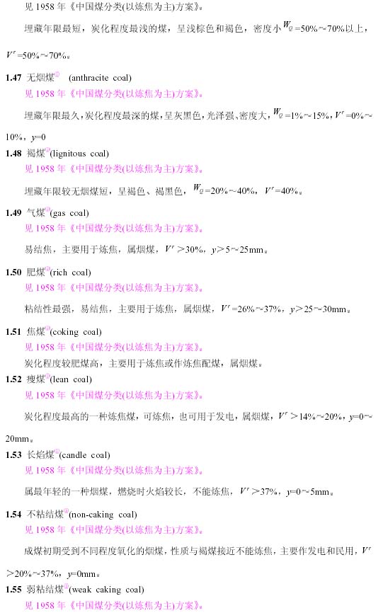

灰分和硫分较低易洗选属烟煤可作配煤炼焦V r 20% 37% y=0(成块) 9mm
+ d$ \4 n7 ^1 S1.56 分煤(steam coal)/ u$ O, R6 F; k1 G: h5 t( _6 X
见1958 年中国煤分类(以炼焦为主)方案
8 B6 ^' Y5 I$ Y; p0 v. L炭化程度比瘦煤更高的烟煤一般无粘结不能炼焦燃烧时火焰短灰分高主要作5 F1 {$ @( V0 y- n' p
动力燃料V r 14% 20% y=0(成块) 12mm4 B' l* V' k* y' Z" L

/ ~* c* r5 H. j; s" ~, V1 W1.47 无烟煤anthracite coal# a8 e5 R! F( n, x+ `! `0 w
1.48 褐煤lignitous coal
7 X2 N3 O! s, a! g# w+ l1.49 气煤gas coal
1 R, h  |- [1 {+ u1.50 肥煤rich coal
3 A" M9 l8 Z. w5 S. ~1.51 焦煤coking coal
8 T# z, k& k; f1 x1.52 瘦煤lean coal
4 n- U9 f) ^  {0 ~+ ]: n1.53 长焰煤candle coal1 `0 c$ t  P* e( [1 v
1.54 不粘结煤non-caking coal
  x! C: `* [9 {1.55 弱粘结煤weak caking coal
! R: p( A7 A& f4 L1.56 贫煤steam coal6 C5 K4 W: \' H' g* K: Z
1.57 石千石refuse(rock)- q( P* M  ^7 `, v/ M
1.58 精煤clean coal
3 J4 `& ~; t: q) o* l1.59 煤样coal sample8 f- N5 E% v3 s7 Q+ ~
1.60 原始煤样original coal sample4 B2 Q; t8 e; R. r- l
1.61 分样separate sample
% H/ K( v$ j- p# I1.62 试验室煤样laboratorial coal sample6 z- k( u, j; n! g1 I) m
1.63 分析煤样analysis coal sample
: C- a  C( y+ [% y7 L1 z5 ~1.64 煤样缩制coal sample reduction6 q' a; s' @% k/ S7 Q. t
1.65 筛上物(筛分剩余量) screen overflow
* ]6 P  l$ A# K, {6 e1.66 筛下物(筛分通过量) screen underflow0 |0 }0 o8 P+ p% B5 n. |
1.67 筛上粒级oversize+ y0 E! J9 ?) f. L4 A$ }7 w) j
1.68 等厚筛分screening process with constant bed thickness1 ]) q" i3 Y  X
1.69 概率筛分probability process
9 J4 y; R( I8 P' q+ N9 F+ Q2 S8 C1.70 煤的破碎breaking of coal; v, O; {' E, [5 E# a5 A8 W
1.71 破碎比size reduction ratio
