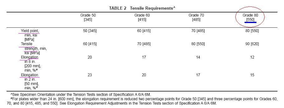

最近拿到一套国外图纸,涉及到许多国外材料,不知ASTM A656 GR 80(板厚 19mm)是什么材料,最好提供化学成分和物理性能,我好作比较

ASTM A656/A656M-2005e1
% k- j3 g7 ~, t# g; k6 S: Z) f
# S7 e, d8 F( B7 o中文标准名称/书名:  具有经改进的可成形性的热轧结构钢、高强度低合金中厚板规格
: A( `( G% q9 r
; J9 a4 |2 M1 m+ Z9 U  V2 D英文标准名称:  Standard Specification for Hot-Rolled Structural Steel, High-Strength Low-Alloy Plate with Improved Formability

见ASTM A656 A656M-2003 Standard Specification for Hot-Rolled Structural Steel...ASTM A656 A656M-2003
' ?1 @6 m5 g9 l3 C" uStandard Specification for Hot-Rolled Structural Steel, High-Strength Low-Alloy Plate with Improved Formability3 ^& r! ]3 f% r3 _! ^5 N
http://www.3dportal.cn/discuz/viewthread.php?tid=272547&highlight=ASTM%2BA%2B656中:
' h3 z" k2 J0 f2 F 1.JPG 9 b  L$ z# S& o& O: r
实际材料:A 656 Type 3 Grade 550
' K3 F: {! F% _, a2 _" |
材料牌号:A 656 Type 3 Grade 550
标准:ASTM
国家与地区:USA
钢组:结构钢
次级类别:ASTM A 656/A 656M Hot-rolled structural steel, high-strength low-alloy plate with improved formability
用途:Use for in truck frames, brackets, crane booms, rail cars, and similar applications

化学成分 (%)
, B/ B3 U/ y* q
http://www.key-to-steel.com/cn/img/nav/spacer.gif7 \+ m: S) T, f  E8 [
元素最小最大近似的
C : q# C* b) v3 z8 X3 ^' o- x% ~
0.1800 & _3 @3 S7 o+ d  J1 L
Si ; A1 J0 a/ K' ~5 q7 V7 }
0.6000
9 n8 y. k) \! k0 ^$ s
Mn 8 U1 l6 J# Q8 w
1.6500 9 ?. @1 ~9 s! B+ @
P . V9 u/ s) l1 T4 e  C$ S
0.0250 6 E. G, X3 x/ o% }2 i
S " g% P$ p' _, `4 X
0.0350 " G5 n4 N& ]) }, `: n. e
V
* Q: b9 a4 ~- |, P9 B+ M# {
0.0800
1 y$ G! O& g1 j6 p1 B) ?" I5 y+ [
Nb 0.0080 0.1000
/ [9 b8 U+ S+ ]6 M  }: Z( r3 I
N
) x- U# A. [/ K6 p  J
0.0200
/ @4 \) h3 y& u1 U  n) O" A
材料属性 0 n4 b! a: E3 O* @9 c# k: {- k$ P
% z* M( \& Q3 @9 O$ l& i
最小最大近似的
厚板; 轧制; t <= 20 mm
屈服强度 Rp0,2 (MPa)550--
抗拉强度 Rm (MPa)620--
伸长率 A5 (%)15.0--
