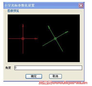

 楼主| 发表于 2015-12-17 09:18:52 | 显示全部楼层 来自: 中国安徽合肥
  q9 B/ d5 d: ^1 z4 m. s) o7 H) a8 d5 q% e0 z
/*对话框*/
  h& s1 d8 x: O1 ^  Y7 `) n0 Kshizi:dialog{7 B7 l* s3 A7 F0 w
label="十字光标参数化设置";
* ^, i- G" f2 d7 K- c:row{( o; \& U/ \2 x/ F# {
:boxed_radio_column{( _$ }$ l2 c6 i% o; u
label="图像预览";
- d3 Y7 q: X5 b, X9 P; `:image_button{
0 g* e' ]; `- B$ I  h! \' `1 f! Zkey="Kimage";$ j- _" ~, v+ u+ ~2 V5 q
color=-2;) }+ ~2 P& W3 B( l
width=50;
0 N4 |' M8 t# d8 Laspect_ratio=0.66;
( Y  e' ]$ H( L5 X- z" N9 X2 f+ o}}}
5 M/ E+ R! T. k:row{7 P5 O; D6 X/ W4 P
:edit_box{label="角度";key="ang" ;}
. K! H  f0 f1 r$ f4 {" U% ~% c8 N& |9 S0 @6 A
) r6 C* V! V  a- u, Hspacer_1;* ?1 m/ p" ?1 C% G+ q
ok_cancel;
8 {$ ], U$ A, l7 f}
0 G! [. y( p* i! y) L+ C3 G
! H; Y# Z1 t" a9 n/*说明此程序仅供学习之用,将附页源程序拷贝到CAD安装目录下的SUPPORT文件内,加载后命令行输入szg。*/
5 l- z& r! A4 w( V2 v# a% w$ t  Z(defun C:szg ()) x' I7 B( E: |# q
  (setvar "cmdecho" 0)$ h( i, o1 P! H; y! t) O( q
  (dcl_tuxiang)
. g/ R7 C" c' O! c9 r6 @& f: ]. H  (princ)
# m: o# X2 g6 Z/ e4 N)" s3 h! ~& M- e3 f  k* _
(prompt "\n<命令szg> 程序设计 作者 yinchuan99001 2015-12-15");END
2 [. E4 y; o" ]  x;调用对话框子程序
5 Y; d6 U8 Z) u! w* T% M( i% o" g(defun dcl_tuxiang ()# K/ {" G  h8 Z& s* Z7 [: e/ L. u8 {
  (setq dcl_id (load_dialog "十字光标.DCL"))
; J/ x* Z) g+ p2 t  (new_dialog "shizi" dcl_id)2 C5 N2 d) T9 L2 [% A
  (show_sld "Kimage" "十字");图像位置在AutoCAD安装目录support9 p+ f) b. m4 r, ~
  (set_tile "ang" "0")
, @1 K  U5 Y* {* u9 i! ?  (action_tile "Kimage" "(tu_xiang)")
% p! c4 a: n$ j9 |# }  (action_tile "accept" "(ok_ang)(done_dialog 1)")1 }% W; B+ O) U. ?
  (setq dd (start_dialog))4 B" O. l8 ~, r1 Y
  (if (= dd 1)
* e4 p+ ^! G+ L4 v$ e( @# a   (nap)        ; 调用子程序(nap)) }6 @% y0 N! U% h  {4 |' O
  )" Z2 h  q: W7 [+ T4 L( j: J8 E: Q$ }
  v0 h% T9 J/ G7 [3 P- w3 y;图像显示
* O% i# W5 M0 I% Y7 N; }& X(defun tu_xiang        ()" U( W3 J) V0 b# z: J3 w5 b' a
1 R7 \; W! f( }3 s. f5 E8 Q( L4 ?                                        3 o& B0 Z, _# u7 s! b5 J
)  u1 H9 Q* ~4 g2 E( l' H7 \
;子程序ok_ang
) k# l, C  R+ u1 d(defun ok_ang ()
- x( q5 h* {+ g$ Q  (setq ang (atof (get_tile "ang")))3 D$ a1 H0 p- k9 B$ [
" |& @/ Y/ ?+ S0 M
)% j5 c7 Q. n3 g6 m+ ^9 A1 o
0 {' o3 [! m7 s( L2 o4 f% |;两个自变量图像处理2 h/ M! [  e4 N) T. G- y1 ~: ^
(defun show_sld        (key sld)
. Q3 a( K9 M# h, U  (setq x (dimx_tile key))9 K% @4 h, @% C
  (setq y (dimy_tile key))  h, J" w# n# Q
  (start_image key)+ X1 x$ `" w7 x! }, ?
  (fill_image 0 0 x y -2)1 h( p( t" `; g' [3 ?! o7 X
  (slide_image 0 0 x y sld)
, F* r' D, F  }$ _5 d4 T6 D. ]5 s  (end_image)( R6 l+ A9 h1 n! k; p( g: h
)! g- Z9 [% m: ?! x: ^& p& _
;子程序nap* e6 l5 p6 s+ k+ H1 W
(defun nap ()
/ e- K  {7 K6 g3 L! }1 E4 ^  (setvar "cmdecho" 0)
4 d. Z+ B5 F. G. w# L* U* Z  (setvar "blipmode" 0)
; I+ H3 g! ?' Y7 V9 \  (if (= 0 ang)' A0 L$ w* I# d8 s: z
    (progn. C# |: [# ~0 r/ D& l
      (setvar "snapang" 0)
, o' }! g) e! C. T) I. f- p9 @    )
2 ?; X3 g, z8 d' ]' `    (setvar "snapang" (* pi (/ ang 180))). w9 I% `/ l; L
' _$ w  v5 ]. e4 R9 m)
+ r8 U0 U6 p/ [. s# ~3 k$ W) p# w: V7 n7 V
6 z, D' Y+ A4 u) @2 s+ u( A
7 t* ~+ ~( \4 g5 U. E4 m, y* X6 g解铃还须系铃人,上述lisp仅供学习LISP语言的同仁们参考,有不足或不对的地方请大家指正。 (若有引用,请注明引用地址和作者)
