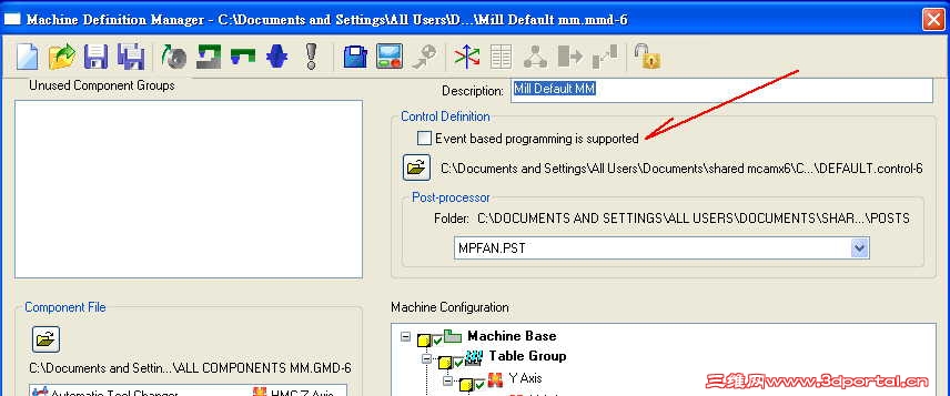

Event-based programming is supported.) H2 Z$ h- z4 x4 @. U5 T/ O
汉化程式不管是正版或哪一版,只要碰到这种句型,必然译得让人摸不着北。
6 U3 \4 M. i# Y% b, m" e# `$ Z& V2 X$ r" o$ E2 {) }
1.汉化A版译为 : [支援基础编制程序项目]
% c9 @- x" L0 r: T# m7 z/ S& Z2.汉化B版译为 : [支援基本编制程式事例]) m) n5 u- C1 |4 u$ ?5 W
3.正确的译文,请各位踊跃提出。

event based programming is supported 字面意思 ,程式调度事件支持
2 a0 P, z8 ?+ g7 A0 H2 ]! F官方说明,
, ~. i/ l4 Y8 V9 m- C7 `Event based programming is supported
7 n4 z0 B( P8 _) t' l, u+ o) ]6 MSelect this option if you are running Mastercam MultiTasking and your post processor is configured to support tool change event lists and other event-based programming. Selecting this option activates the toolbar buttons for advanced MultiTasking programming features, such as machining modes, data streams, macros, and event lists.
6 h; k% {# O! UIf you are not running Mastercam MultiTasking, do NOT select this option.5 {! A$ t% P6 W3 O" e6 ^& h! W7 r4 H& j
支持复合机,流水线等自动化机器,换刀等调度等事件。
2 t" m! M( x. q1 ~' Z) i/ M5 T1 v% `5 x从 for advanced MultiTasking programming features, such as machining modes, data streams, macros, and event lists.
7 A3 C6 Q% R2 Z9 ^6 `可猜测  用 宏,数据流,事件等方式控制,实际上应该都是调度方法。) O4 U! _+ s6 v4 h" L9 ^) ~7 W1 L
在车削中有 有even lists,如主轴吹气、送料、接料、翻转、同步等,可插入代码。( T( R( u. {1 ]: B
* P# S% `, x7 DX6没有此项,猜测在Mastercamrobot中有。

我认为起碼应该这么译才对,才会从字顺,看得人豁然开朗。
% s) {- o$ R& [5 d2 q$ n; I7 n
  E3 R  j; V, B3 r- b( HEvent-based programming is supported.
! F( t$ l" r* J" S支持以事件为基础的编程
