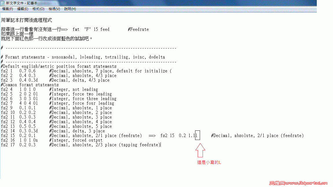

本帖最后由 norno 于 2012-3-17 12:00 编辑 4 I6 U' [; ^& g* X
- I2 M3 S& s) {9 ^% I- j8 o用筆記本打開後處理程式; d& z3 j9 ?. v+ W2 h8 g
, V; d$ F4 Q% ?- o# u) ?
搜尋這一行看看有沒有這一行==>  fmt  "F" 15 feed        #Feedrate
$ W+ E5 g7 A: |9 O# q3 r8 o! I如果跟上面一樣
& V% u# H0 X$ L9 o, ~* V就把下面紅色那一行改成後面藍色的試試吧。% M! V" d  p" X( r8 Z
( S2 v/ A8 l9 s
7 O3 L0 Z( t7 L% [8 _' P, }% _" B; h/ E6 _
# Format statements - n=nonmodal, l=leading, t=trailing, i=inc, d=delta; b6 p8 S! O9 G3 Z  x' B, M# x
# --------------------------------------------------------------------------, J; M9 @; N! E3 n3 y* l$ i, d
#Default english/metric position format statements& `1 t9 ~. A. M. R
fs2 1   0.7 0.6      #Decimal, absolute, 7 place, default for initialize (" d1 c: ^: e4 f$ g$ w
fs2 2   0.4 0.3      #Decimal, absolute, 4/3 place$ I6 U! o+ X) h3 F" A- O+ X
fs2 3   0.4 0.3d     #Decimal, delta, 4/3 place
9 s. e) A1 B% j1 J+ H, {3 g#Common format statements2 A9 U; u/ a/ Z- l9 p* M& x
fs2 4   1 0 1 0      #Integer, not leading
" `1 g2 D5 a) k$ o/ z! `fs2 5   2 0 2 0l     #Integer, force two leading9 [* v# V7 ^$ o# P# ]
fs2 6   3 0 3 0l     #Integer, force three leading( i2 F! Z( l+ A$ j( d. b7 i
fs2 7   4 0 4 0l     #Integer, force four leading
! J: G! a  T0 |% b( V8 Ffs2 9   0.1 0.1      #Decimal, absolute, 1 place$ b+ k  ^0 l; d; z2 ?; x$ @+ j
fs2 10  0.2 0.2      #Decimal, absolute, 2 place
. O; G& S/ K! \& h4 K1 lfs2 11  0.3 0.3      #Decimal, absolute, 3 place
7 }& ?5 N) n5 Pfs2 12  0.4 0.4      #Decimal, absolute, 4 place
' d8 X2 M2 u1 n6 l- y7 pfs2 13  0.5 0.5      #Decimal, absolute, 5 place- W: a" K, V3 v" Z0 S) q
fs2 14  0.3 0.3d     #Decimal, delta, 3 place
5 N. N9 M- K0 O* y6 t5 Ifs2 15  0.2 0.1      #Decimal, absolute, 2/1 place (feedrate)   ==>  fs2 15  0.2 1.1l      #Decimal, absolute, 2/1 place (feedrate)* M! N+ `- S3 f/ T3 q
fs2 16  1 0 1 0n     #Integer, forced output
7 M8 j! Y# d* s: S9 B1 R# Gfs2 17  0.2 0.3      #Decimal, absolute, 2/3 place (tapping feedrate)# Q2 H1 h1 P( o2 ^
