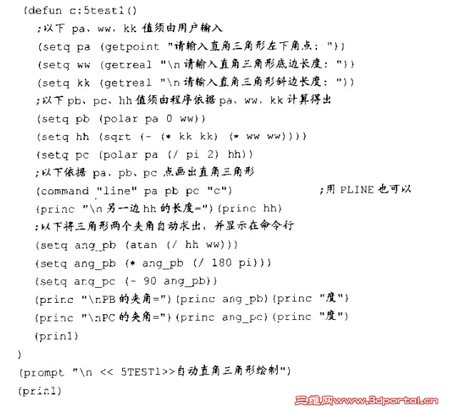

6 f1 [, I! U$ [$ y' i程序怎么出来是一条直线呢?书本也是这样的,谢谢各位指点一下
  1. (defun C:15()
    3 H+ I" H3 G& K* I: G; x
  2. (setq pa (getpoint "请输入三角形左下的点:"2 [& s4 ^3 t0 h* F2 ?1 v) Y- I
  3. (setq ww (getreal "\n 输入底边长度:"9 c0 Z0 p9 X" ^* j: w
  4. (setq kk (getreal "\n 输入斜边长度:"
    ( z* h% e4 H, q
  5. (setq pb (polar pa 0 ww))& J. L4 W+ v9 E0 F+ _3 g
  6. (setq hh (sqrt (- (* kk kk) (* ww ww))))
    ( M0 g) V- N1 h
  7. : m' _! M- t5 _
  8. (command "pline" pa pb pc "c"
    % e: f& x$ A0 `$ R6 _
  9. (princ "\n 另一边hh的长度=" (princ hh): `$ V0 B' U- G) U8 I3 q
  10. (setq ang_pb (atan (/ hh ww)))4 B" h" ~  P1 m, r/ n
  11. (setq ang_pb (* atan_pb (/ 180 pi))) . R  u, C* t$ c; x7 J- G0 f; U
  12. (setq ang_pc (- 90 ang_pb))) n' @/ ?  u! z9 V9 W, W, c1 o5 ]1 c
  13. (princ "\n pb的夹角=" 6 _/ E/ Y/ M) e& d* |
  14. (princ ang-pb) ( g7 x- M' U1 I% z4 N
  15. (princ "度"5 b, A5 S- S  Z/ \+ k% j- j4 Z
  16. (princ "\n pc的夹角=" ' s) \+ L+ Z7 ]% [1 U: t
  17. (princ ang-pc) , M. {# J6 Q& e0 Z9 V$ ~
  18. (princ "度"
    : f) `+ c  D  G& v3 k, ^$ e& l) F
  19. )$ U' h0 L3 N, w  X5 R8 O
  20. (prompt "\n 自动完成 "
    ; W, g) C" \1 o7 X: O
  21. (prin1)- a! w/ e8 H. W# |/ i7 |
复制代码
发表于 2011-5-21 22:26:43 | 显示全部楼层 来自: 中国台湾
# H( y9 ]$ m7 L5 X(princ ang-pb)% Z) ?& F9 A4 C+ J& R) m# ]0 z
(princ ang-pc)
* o2 V) f3 P1 {7 B
==============, X; G# c# M) A
  1. ! ]# F& T6 c* B( b. b0 s
  2. (defun C:15 ()' V& d) v- _5 j* a4 x# }
  3.   (setq pa (getpoint "请输入三角形左下的点:"))
    4 s; t% r  d, Y) I! p; p8 N' z
  4.   (setq ww (getreal "\n 输入底边长度:"))( |% F+ H5 A+ v7 G. j& L3 n( q
  5.   (setq kk (getreal "\n 输入斜边长度:"))9 Y. t7 C" }8 u+ s
  6.   (setq pb (polar pa 0 ww))/ |( Z+ P; R9 `* s# g1 C- |
  7.   (setq hh (sqrt (- (* kk kk) (* ww ww))))! F4 `3 J+ g  W, z# u/ \
  8.   (setq pc (polar pa (/ pi 2) hh))
    - r6 K4 E3 N9 a4 r$ Z
  9.
    4 \& n' _: r" z2 r! \: W
  10.   ;; (setvar "OsMode" 0)  ;捕捉
    ! `& v; k% H+ j
  11.   (command "pline" pa pb pc "c")9 V4 L" n! ]/ n7 @# R4 [
  12.   (princ "\n 另一边hh的长度=")* \7 C0 i+ x- s8 R( `
  13.   (princ hh)
    3 X+ W$ S+ s( f9 C5 C# Q/ {) S% l! }
  14.   (setq ang_pb (atan (/ hh ww)))
    9 \' _' C+ l9 W; L5 q& M' v
  15.   (setq ang_pb (* ang_pb (/ 180 pi)))( Q1 [# f) E5 ]) @/ v
  16.   (setq ang_pc (- 90 ang_pb))4 [5 J2 {$ U" z, L1 D
  17.   (princ "\n pb的夹角="); K" U# k$ Q3 D9 }/ ^& Z
  18.   (princ ang_pb)  (princ "度")
    5 C" Q% h- z  Y5 u8 c/ }7 r; \
  19.   (princ "\n pc的夹角=")  (princ ang_pc)- k( u, |2 }8 m6 |
  20.   (princ "度")5 _4 J! w* k5 G- k
  21. )
    ( j4 l9 g8 `+ [3 U* ^$ P3 t
  22. (prompt "\n 自动完成 ")1 w# L  V0 g  r1 `( [: k/ |) \, |# u
  23. (prin1)2 G5 {3 A7 [$ K# a- m
复制代码

 楼主| 发表于 2011-5-22 14:24:01 | 显示全部楼层 来自: 中国广东广州
2# SunVei
9 T6 U1 M7 ]. O' _谢谢啦,确实可行啊,麻烦可以指点下出现什么问题了么?

发表于 2011-5-22 18:06:25 | 显示全部楼层 来自: 中国辽宁
缺少第7行(计算pc的那一行)
 楼主| 发表于 2011-5-22 20:35:25 | 显示全部楼层 来自: 中国广东广州
5# woaishuijia 7 w  k7 ], t2 O6 i
/ B+ }4 |3 ~3 E! A9 H5 z
呃。太粗心了,谢谢两位高人啦。

发表于 2011-5-23 02:55:58 | 显示全部楼层 来自: 中国辽宁
按lisp的规矩,函数运行结束后会显示函数的返回值,也就是最后的结果.具体到这个例程,就是最后一行(princ "度")的结果:显示一个字符"度"
; u/ d, T1 E$ p1 f在自定义函数的最后一个右括号之前添加一行(princ),函数的返回值就成为空值了,就不会有多余的显示.
  1. (defun C:15 ()
    . \+ _: C5 l) }; v9 R' x
  2.   (setq pa (getpoint "请输入三角形左下的点:")): B" ]7 r! }1 N2 ^& s6 u% U
  3.   (setq ww (getreal "\n 输入底边长度:"))8 |$ a; O( T+ E  H! v4 w. r- R
  4.   (setq kk (getreal "\n 输入斜边长度:"))
    1 `0 `! t) g4 R2 x+ e/ \  R
  5.   (setq pb (polar pa 0 ww)); F% ^* K+ ?- C$ b
    # y6 U% U8 z0 L- f$ p: m/ i
  7.   (setq pc (polar pa (/ pi 2) hh))
    * o- ^7 h7 v7 K$ N
  8.
    4 T* ]1 _% C0 f, s! k7 [7 L5 j
  9.   ;; (setvar "OsMode" 0)  ;捕捉
    : `6 V9 b  F- w
  10.   (command "pline" pa pb pc "c")% U( W, Y7 {7 @2 H1 c2 F% N2 t# w+ V
  11.   (princ "\n 另一边hh的长度=")
    / ~+ }' P3 k: i/ }1 t7 m3 c( F& D; B
  12.   (princ hh)  c6 R" \) ^( X+ e5 ?, T2 q0 I) \% ]
  13.   (setq ang_pb (atan (/ hh ww)))
    8 J# M0 ^, p) y; P  l
  14.   (setq ang_pb (* ang_pb (/ 180 pi)))
    - o" t6 B# Y4 K. x1 M. ^9 f- D
  15.   (setq ang_pc (- 90 ang_pb))
    3 r% ^& r7 \. G- o$ E
  16.   (princ "\n pb的夹角=")4 u9 g! i% o3 \4 h/ b7 S+ T
  17.   (princ ang_pb)  (princ "度")
    . N) t9 U" N$ w% [4 P! f2 q# t' _
  18.   (princ "\n pc的夹角=")  (princ ang_pc)" e, l* d" E# k" U- m  D# S
  19.   (princ "度")
    6 T- D! c8 D: C! m0 f+ u  t) ~! D
  20.   (princ)
    2 s5 P: `% \) Q4 p
  21. )  d: N2 Z, G; q9 j, ]6 p
    6 G  E7 [1 _% M9 _* J4 @: U# ~
  23. (prin1)
复制代码
