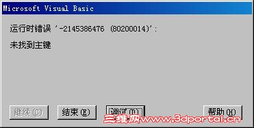

* R' r/ F- ?9 `3 R/ [我要新建图层,并要设置图层线型,但是我在设置中心线的时候出现问题,提示未找到主键,程序如下:0 b4 o( U% q7 {* l+ n  N/ X. k
" A- m5 [! Z# b/ |+ {
  1.     Dim layer As AcadLayer' D, @' R+ V& j; V
  2.     Set layer = ThisDrawing.Layers.Add("ZXXC")        '中心线层
    5 t# P. k& q: Y% N  ~
  3.         layer.Lineweight = acLnWt018
    5 p7 D) H3 W3 D
  4.         layer.color = acBlue9 f( C7 m! S, K4 m
  5.         layer.Linetype = "CENTER"
    % b9 M1 U, ]+ C" L4 }( C5 |
  6.         ThisDrawing.ActiveLayer = layer
复制代码
  `' o* U4 p* N* r
# L5 S" |0 f" \: r5 B6 U3 K1 S
出现问题的是:layer.Linetype = "CENTER"
) h. Q! X4 ~+ O8 G' \2 y) _0 F提示如下:1 o# \; X* f. E' s
4 ]3 E' s; d* t- ~0 e9 y) s, I请帮助,谢谢。

设置线型之前应保证线型已被加载
    ' J0 S$ T& z! {" \# d% _
  2.     Set layer = ThisDrawing.Layers.Add("ZXXC"  )      '中心线层
    . P! Y% B$ M3 L2 l' x) d7 J5 R
  3.     layer.Lineweight = acLnWt0186 I6 Q( u8 I, F& i/ X
  4.     layer.color = acBlue) E% Z# P  Q: W
  5.     ThisDrawing.Linetypes.Load "center", "acadiso.lin"7 q, `9 ]5 u1 X
  6.     layer.Linetype = "CENTER"

" S8 ^+ n! P% d0 F如果已经加载了center线型,再加载的话会报错,所以最好做一个判断。如下:
# \6 R9 a' b( K' L8 X. ]8 S, E
  1. ii = 0                              '如果未加载“CENTER”线型,则加载6 r, M- \" m7 L* h5 t1 ^& ~1 V
  2. For Each element In ThisDrawing.Linetypes
    ! E6 j3 a  \' |
  3.     If element.Name = "CENTER" Then
    ; o& L& k: f7 ^3 q4 ?% D$ v
  4.         ii = 1
    0 w# x: j) }4 H: i% L5 ?
  5.         Exit For1 {% G0 I2 s+ p) A
  6.     End If! s6 k# M& b  _& X: W" G7 a3 w0 Z
  7. Next element( N3 h! ?( \* b4 z( B& Q1 S0 O
  8. If ii = 0 Then" \$ d, O1 L0 |9 }- }* `$ P4 r6 C( ^
  9.     ThisDrawing.Linetypes.Load "Center", "acadiso.lin") N8 \7 g' v, W
  10. End If$ z7 S9 y. `6 S
复制代码
$ f+ m  M% Z- }* ]- X, @
图层、选择集这些最好也这样做一下判断
