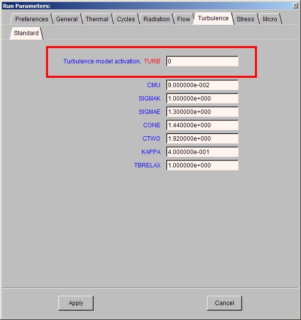

 楼主| 发表于 2008-4-14 04:05:50 | 显示全部楼层 来自: 俄罗斯
原帖由 chinalaowang 于 2008-4-13 20:40 发表 http://www.3dportal.cn/discuz/images/common/back.gif
/ n0 s1 Q. t. N- `* N并行运算用不了啊?!
. f, N" {1 F6 cThis feature is not accessable in ProCAST2008 Windows... You can run a Parallel Solver for TURB only in Linux version!

3 a9 W0 _, {2 N# S9 S  t“TURB”是啥东西啊??本人愚笨。是不是除了TURB别的都可以并行运算啊?
8 f0 x" |' P, ^1 Y8 ZMaybe it will be better to read a ProCAST2008 Help & Manuals ?
8 a4 B* \- g* N3 f2 MParameter “TURB” activate or deactivate turbulence model calculation... In ProCAST2008.0 for Windows for Parallel Solver “TURB” not equal 0 is not suppoted

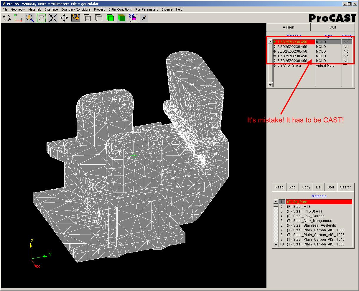

 楼主| 发表于 2008-4-15 04:16:25 | 显示全部楼层 来自: 俄罗斯
原帖由 myway198 于 2008-4-11 07:28 发表 http://www.3dportal.cn/discuz/images/common/back.gif
  _* i% C3 }0 M& e' q* `" \% |+ I贴上图及出现问题的DAT文件,再次出现问题
3 g6 b6 M% S$ v4 `! Y, i$ w- Lin reply to post #65! g& `/ g  ^- i; u& [' V
I looked your problem project..8 h5 L, }' M) A! c1 A
There is no CAST in your project! It's mistake, couse ProCAST nothing to do in that project!$ w2 P& r5 w4 ?  R# `3 S
So if you will change Mold for CAST all will be OK! \3 C  p! J7 J' K

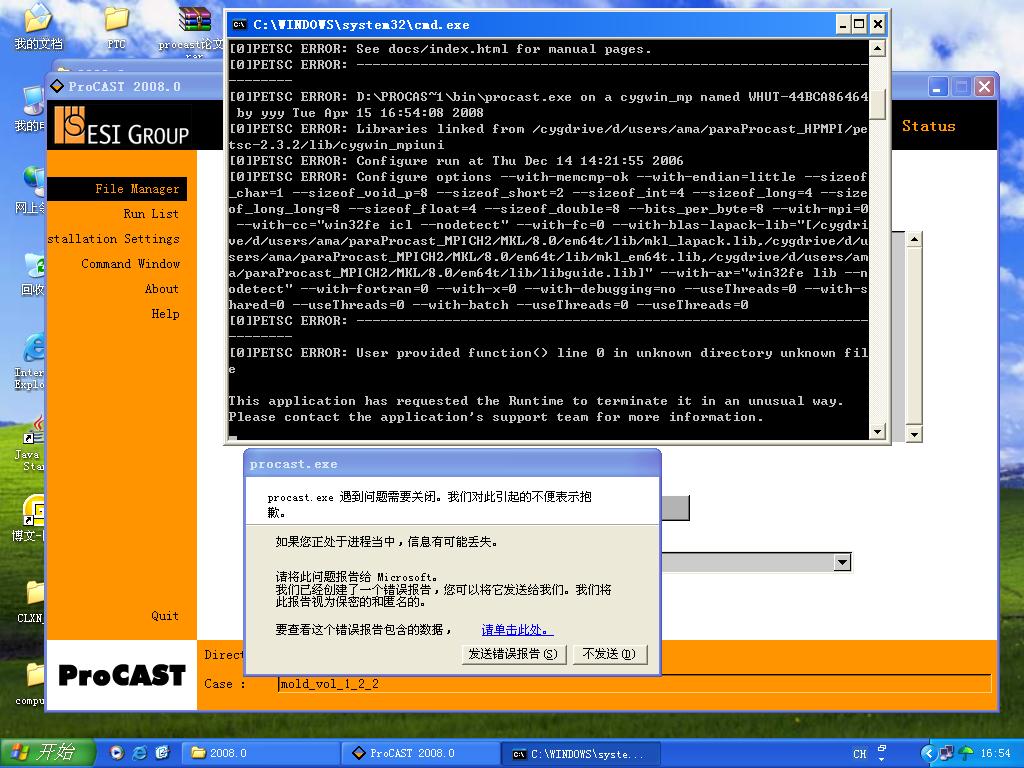

发表于 2008-4-15 16:58:14 | 显示全部楼层 来自: 中国湖北武汉
为什么我安装的PROCAST2008在计算时会出现下面的问题(用的是自带的测试文件),请大家帮我看一看,谢谢!
