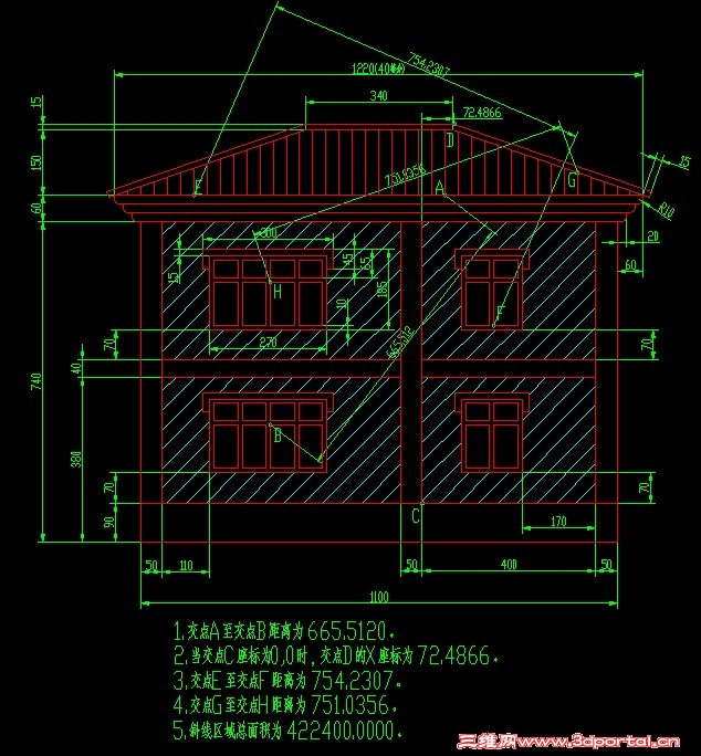

CA D几何作图竞赛题(2012年10月),至10月24日止 s: i% u9 r0 g7 A
7 ]9 X: V2 U; R5 n; u& d) B
一.竞赛题目(参见附图)
9 s6 c2 P2 _! Z0 V+ ]+ d+ l4 f
W3 m7 f. d0 E0 L" r# S基础综合练习57: X) m, w: z* y
+ X" N3 g; |3 a) L* t, `
用AutoCAD作图法求出该题要求的5个数值,
# j; w5 q8 r% p! ?! h! S/ ^
# b8 g2 \: a) v尺寸精度要求精确到小数点后4位。角度单位必须使用十进制度数,不得使用度/分/秒,百分度和弧度,精度也要求精确到小数点后4位。" R# r( r+ x x8 P

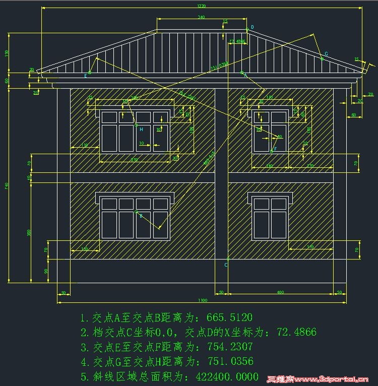

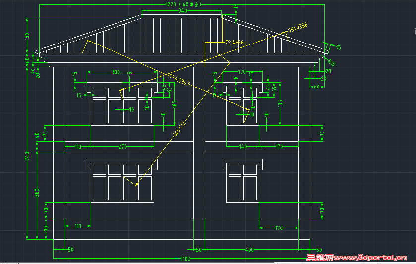

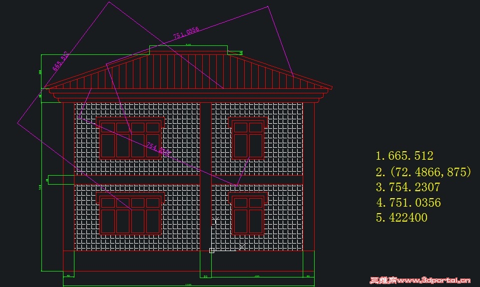

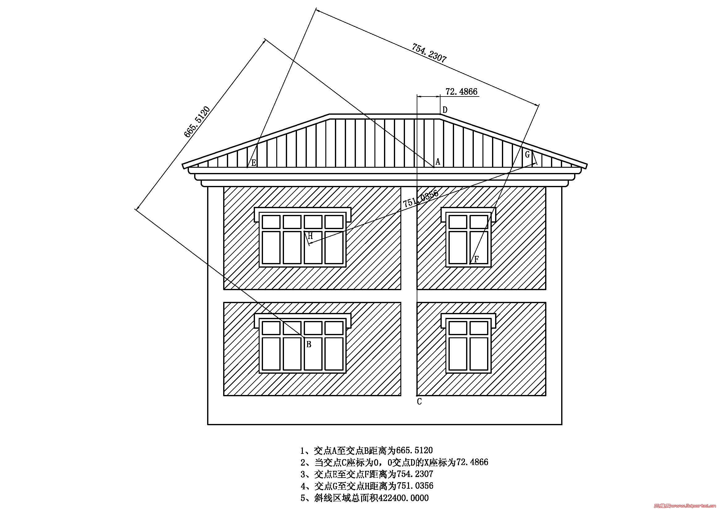

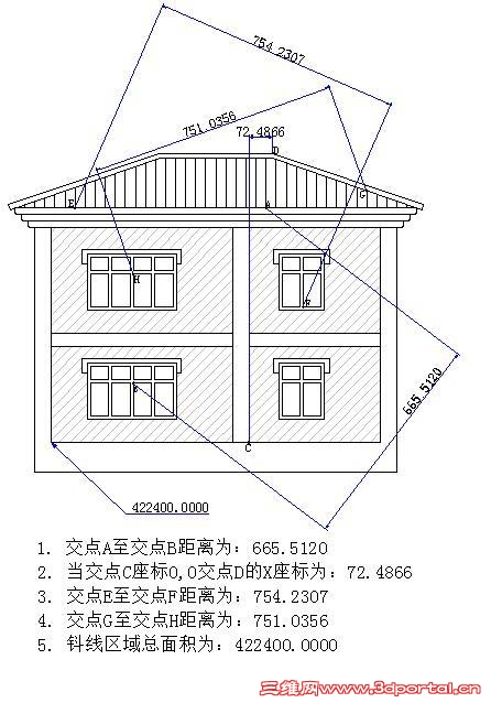

) t& @( `) r6 X" | ]竞赛已结束,初步评定成绩见下表,请参赛网友自行核对成绩.如有异议,请于三日内在本主题帖后跟帖说明.三日后正式颁奖.
1 s2 U+ e% R( ^楼层 | 用户名 | A | B | C | D | E | 正确数 | 标准答案 | 665.512 | 72.4866 | 754.2307 | 751.0356 | 422400 | | 3 | inuyasha_pw | 665.512 | 72.4866 | 754.2307 | 751.0356 | 422400 | 5 | 5 | qq625267377 | 665.512 | 72.4866 | 754.2307 | 751.0356 | 422400 | 5 | 6 | zyyyyp | 668.5479 | 57.5 | 767.0958 | 763.5139 | 42400 | 0 | 7 | 冰冻咖啡 | 665.512 | 72.4866 | 754.2307 | 751.0356 | 422400 | 5 | 8 | ysa830224 | 665.512 | 74.8401 | 754.2307 | 760.4634 | 422400 | 3 | 9 | gongwen0519 | 665.512 | 72.4866 | 754.2307 | 751.0356 | 422400 | 5 | 10 | ysryc99001 | 665.512 | 72.4866 | 754.2307 | 751.0356 | 422400 | 5 | 11 | chenqi | 665.512 | 72.4866 | 754.2307 | 751.0356 | 422400 | 5 | 12 | lxf325 | 665.512 | 70 | 754.2307 | 751.0356 | 450900 | 3 | 13 | S0501 | 665.512 | 70 | 754.2307 | 749.2293 | 422400 | 3 | 14 | wupeiqi | 655.512 | 70 | 754.2307 | 750.445 | 422400 | 2 | 16 | LIAIYAO | 665.512 | 72.4866 | 754.2307 | 751.0356 | 422400 | 5 | 17 | mgame168 | 665.512 | 72.4866 | 754.2307 | 751.0356 | 422400 | 5 | 18 | 一路彩虹 | 665.512 | 72.4866 | 754.2307 | 751.0356 | 422400 | 5 | 19 | cyanapple721 | 665.512 | 72.4866 | 754.2307 | 751.0356 | 422400 | 5 | 20 | megumi | 665.512 | 70.875 | 754.2307 | 751.0356 | 422400 | 4 | 21 | 啥也不会 | 665.512 | 70 | 754.2307 | 751.0356 | 422400 | 4 | 22 | gerald_lee | 665.512 | 70 | 754.2301 | 751.0356 | 422400 | 3 | 23 | sh_mrhg | 665.512 | 72.4866 | 754.2307 | 751.0356 | 422024.2725 | 4 | 24 | pppsheng | 665.512 | 72.4866 | 754.2307 | 751.0356 | 422400 | 5 | 25 | chuhanshe | 665.512 | 72.4866 | 754.2307 | 751.0356 | 422400 | 5 | 26 | Pict
% y$ i* W7 ?! E7 v) ~8 k7 Rmountainsheep | 665.512 | 72.4866 | 754.2307 | 751.0356 | 422400 | 5 | 27 | SWJY1956 | 665.512 | 72.4866 | 754.2307 | 751.0356 | 422400 | 5 | 28 | ???????° | 665.512 | 70 | 754.2307 | 751.0356 | 422400 | 4 | 29 | HUA见证发展 | 615.2502 | 69.375 | 754.2307 | 751.0356 | 116803.125 | 2 | 30 | yuansyou | 657.576 | 72.4866 | 754.2307 | 747.7398 | 450900 | 2 | 31 | sanmaosjy | 665.512 | 72.4866 | 754.2307 | 751.0356 | 422400 | 5 | 32 | smartlz | 665.5142 | 72.4866 | 754.2324 | 751.039 | 422387.7536 | 1 | 33 | play-boy | 665.512 | 72.4866 | 754.2307 | 751.0356 | 422400 | 5 | 34 | gorilla | 665.512 | 72.4866 | 754.2307 | 751.0356 | 422400 | 5 | 35 | 凤九天 | 665.512 | 70 | 754.2307 | 751.0356 | 422400 | 4 | 36 | 百陌生 | 665.512 | 72.4866 | 754.2307 | 751.0356 | 422400 | 5 | 37 | zjc1386188 | 655.512 | -20 | 754.2307 | 751.1356 | 422400 | 2 | 38 | 陳志強 | 665.512 | 70 | 754.2307 | 556.4396 | 422400 | 3 | 39 | henan1yzb | 665.512 | 72.4866 | 754.2307 | 751.0356 | 393900 | 4 | 40 | 大隐于市 | 665.512 | 72.4866 | 754.2307 | 751.0356 | 422400 | 5 | 41 | zhou-pei@263 | 665.512 | 70 | 754.2307 | 751.0356 | 422400 | 4 | 42 | 周富铸 | 665.512 | 72.4866 | 754.2307 | 751.0356 | 422400 | 5 | 43 | HBK | 665.512 | | 754.2307 | 751.0356 | 422400 | 4 | 44 | xiaojunxue | 665.512 | 72.4866 | 754.2307 | 751.0356 | 422400 | 5 | 45 | zengyi2008 | 665.512 | 70 | 649.7146 | 749.3073 | 422400 | 2 | 46 | 塔山817 | 665.512 | 72.4866 | 754.2307 | 751.0356 | 422399.9999 | 4 | 47 | jiyongliang | 665.512 | 72.4866 | 754.2307 | 751.0356 | 16896 | 4 | 48 | wheasy027 | 665.512 | 72.4866 | 754.2307 | 751.024 | 422400 | 4 | 49 | qu880919 | 665.512 | 72.4866 | 754.2307 | 751.0356 | 136570.5639 | 4 | 50 | gsyefeng | 665.512 | 72.4866 | 754.2307 | 751.0356 | 422400 | 5 | 51 | 林主0598 | 665.512 | 72.2494 | 754.2307 | 749.3073 | 422400 | 3 | 52 | yinchuan99001 | 665.512 | 72.4866 | 754.2307 | 751.0356 | 422400 | 5 | 53 | 皮卡丘2007 | 665.512 | 72.4866 | 754.2307 | 751.0356 | 422400 | 5 | 54 | yunfei2046 | 665.512 | 72.4866 | 754.2307 | 751.0356 | 422400 | 5 | 55 | rqsjj | 665.512 | 72.4866 | 754.2307 | 751.0356 | 422400 | 5 | 56 | 王老大先生 | 677.7951 | 72.4866 | 754.2307 | 718.1605 | 422400 | 3 | 57 | jin73jian | 665.512 | 72.4866 | 754.2307 | 751.0356 | 430900 | 4 | 58 | yreekf | 665.512 | 70 | 754.2307 | | 422400 | 3 | 59 | 感悟人生 | 665.512 | 72.4866 | 754.2307 | 751.0356 | 422400 | 5 | 60 | hc_yml | 665.512 | 72.4866 | 754.2307 | 751.0356 | 422400 | 5 | 注:表中数字颜色为红色者代表答案错误;空白者代表未提供答案或答案不明确 |
