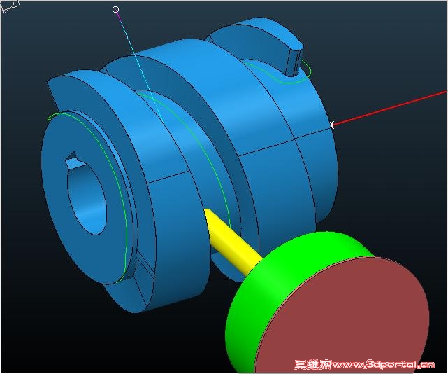

发表于 2011-1-5 11:20:14 | 显示全部楼层 来自: 中国浙江温州
帮你做了一下。3 r" I/ m, C3 h5 {. u$ @( {
%# l( l9 e$ i: e' K0 J
( Date - 04.01.11 - 11:17:26 )
1 F( q% d4 ^7 O3 w( k( DP Version 1510  Option File : FANUC15M-4A )
) O8 u+ c+ K3 O:2_1  v* }. F3 K/ @* G. ]$ W8 L
G05 P10000
+ ^% |# E8 `7 {! v/ e' I; r& M" l( {G40 G17 G80 G49: a, t3 e: Q. B. y% A
G91 G28 Z0.0  W# R; c' c* _
( TOOL TYPE ENDMILL )
$ M/ k) Z) K1 j8 C% b/ R2 U/ T( TOOL ID   D10 )
" R( h. R# m, B! b4 p6 s) p2 d( TOOL DIA. 10. LENGTH 106. )8 j9 d# Y3 m: q1 y' L, n
( ALLOWANCE = +0.0 )
% f* V5 n5 F" S% u. d8 _N1 T1 M6
' Q6 u( @6 K3 ~) a, M$ y3 A( ======== )
9 `) U% z# ~5 z) k0 N/ t% l( TOOLPATH - 2_1 )/ j1 |( z+ c# \2 S9 V
( ToolPath Time - 00:01:08 )
5 o. u3 X; N/ I0 o' \2 o0 x- \$ }/ o7 G( ======== )
/ u4 U7 D( d5 T; lG1 X-70.618 Y51.101 Z50.256 A78.638 H01 F30003 _: P/ O+ s7 r6 o* ]# S, Y
Y46.199 Z49.271' b! a+ |  \! m4 G- E+ y9 G) B0 Q
Y0.0 Z39.988 F500
! V8 Y$ ?8 [. V- o2 d; ]' D: OZ34.988
  E$ n* r7 i0 Y9 w# S' M# ?  C2 mX-70.452 A79.886 F1000- A6 F+ ]; b# J2 q$ j6 @
X-70.289 Z34.987 A81.102
# x0 M- u; X& L! @$ U  BX-70.127 A82.322
( M; l3 N- K1 K+ I; G: _X-69.963 A83.544% z4 {0 R  z& F6 s$ u; S
X-69.8 Z34.988 A84.766
" ~& ~$ O+ D1 R$ A+ _X-69.637 Z34.987 A85.985
/ Q. w* C0 {* ]X-69.475 A87.2+ E5 Z' j+ z; U1 ?, m7 p5 u
X-69.313 A88.413
6 p# g" Q! a4 Y% f6 nX-69.151 Z34.988 A89.625
9 k2 w0 Z2 k/ s0 a  R& n" [X-68.989 Z34.987 A90.835" s% d' _& K7 y7 ^: e0 L* m! t  R
X-68.828 A92.044- O& N/ `1 {. _0 F6 d. b' o
X-68.666 A93.253+ \; R) i. m, v' _6 R% W% Z, F3 V$ d
X-68.504 Z34.988 A94.4620 U& L3 a& H0 `, M/ q! q
X-68.342 Z34.987 A95.676
, o- l: ?+ V6 A9 qX-68.18 A96.883, t. C  f( w& ~) P
X-68.017 A98.097: L7 b1 I5 [7 L- F% I* T+ Z9 e
- O5 M4 n: p- X2 Z  u
8 |- p) D  G# K) R6 I  A4 _
X-73.626 Z34.987 A56.152
' U$ z- ~  K* K; C2 AX-73.464 A57.36& j4 ]0 ]  v/ I# N
X-73.302 Z34.986 A58.57
: r4 R- l* @, Y5 _X-73.139 A59.783
& h. G. o, ?( h* k; e5 }X-72.976 A60.997& g5 J8 s) D# S/ g( Q
X-72.813 Z34.987 A62.215- y( N2 R! A+ Y% a3 l  }
X-72.649 Z34.986 A63.4375 ~: \& _( T1 `% B; g& D
X-72.485 A64.66& d1 e9 Y: k- c. J) c7 F0 e
X-72.322 A65.881
' o6 n1 Y# a0 v- I' EX-72.159 Z34.987 A67.098( X1 u- s9 n8 n! B5 T* i
X-71.997 Z34.986 A68.311% l  N! c) E* K9 d* k9 V
X-71.835 A69.523. e. c' [% V3 {) ~8 d
X-71.674 A70.7331 \7 K$ Z3 H, @4 g) `
X-71.512 Z34.987 A71.941
* h3 ~0 o. H. }2 m* AX-71.351 A73.148! K% F% ^: F# S6 d  s4 k. r* d. j" g
X-71.19 Z34.988 A74.356
- s2 [: n/ y6 X. u+ ~: L. AX-71.029 Z34.987 A75.5637 T, B: ~- a6 A6 x5 y, x) `
X-70.868 A76.771
7 T" H) W" W$ J' g" J! ]X-70.706 A77.981/ V' a& r/ S* ?0 D! g7 m) q/ v9 H
X-70.618 Z34.988 A78.638" k2 O" O7 \( @3 p9 J
Z39.988 F30003 e# _0 X3 h6 j
Y51.101 Z50.256. N& i" U, a0 q2 l1 P* C
M9
& v" e! y  q; O6 \5 e/ N, lG28 X0.06 B; b* v8 \& ]- ]
G28 Y0.0
/ {8 H) z5 {; b! _% V7 IM30
