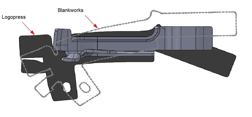

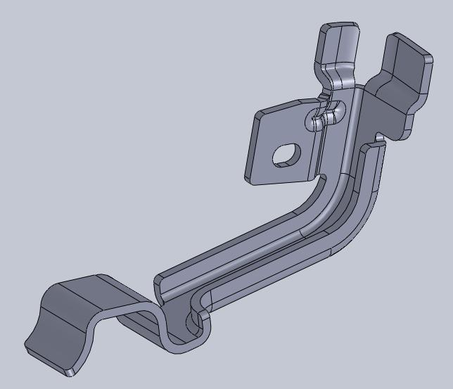

Hello guyz, I have just started to use tooling design software. I have to make a progressive die for this A-3003 aluminum part:  k! r2 I, U( s! r+ s& R
- E: v( q5 U) @+ H" m- eUnfortunately I made a part unfold using Logopress and Balnkworks but they were really diferent:
; q+ W9 Q! E5 B, ^" ^ Part_1.jpg ) o! [/ O! N: k( {0 c! K
Any ideas??

模具结构不一样,顶料方式不一样,料片也不一样
# m- j! J2 a. X9 T可能logo默认有顶料,blankworks顶料需要手动设置

I chosed aluminum A3003 T5 in both analysis, I would like you to try to unfold using another software. I want to know why they are so different.

英文不是太好,从你展开图看,两种软件展开后毛坯尺寸不一样,可能是有些项目设置不一样。对于有些零件用log软件进行冲压展开时,选好压料面后,X、Y方向设置与否,展开的结果不一样。

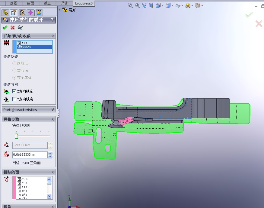

+ Y4 a% ]' l: }% Y+ c6 C; L用log时有没有勾选(单独或全部)图中X向锁定(locked on Xs direction)、Y向锁定(locked on Ys direction)
 楼主| 发表于 2010-1-8 08:34:17 | 显示全部楼层 来自: 墨西哥
This is how I did it using Logopress:
: ]5 `7 D; K7 T. m+ T Analysis.jpg
 楼主| 发表于 2010-1-8 08:40:21 | 显示全部楼层 来自: 墨西哥
I tried to unmark the Locked on Ys and Locked on Xs direction but the result was almost the same. I think a thrid unfolding on a different software would define wich one more accurate.This is the IGS file:" X! b$ I7 C! E) y

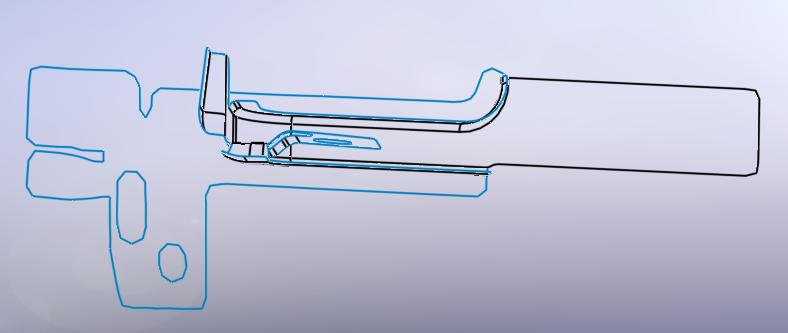

我认为你用blankworks软件展开的比较正确。附件是我用logo展开的,你参考一下。

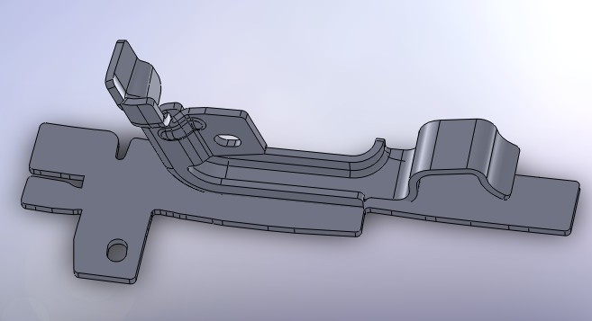

展开后的实体.jpg 展开图.jpg 9 i) Z# P* O. p% Z: i; P
重新用logopress和dynaform软件进行展开,结果一样.

下面贴图为用dynaform展开后导入solidwork的曲面展开图。在导入dyna进行分析前,用logo先将折弯部分展开然后导出曲面到dyna进行分析。上次附件里的压缩文件可用solidwork2008 5.0打开。打开dyna.SLDPRT时可能会提示错误,但不影响打开。里面的曲面为dyna展开的。
