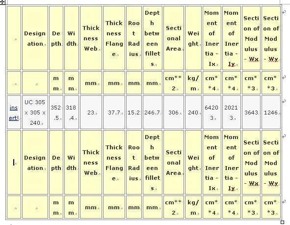

Properties of BSI BS 4-1 British Universal Columns - Metric Units

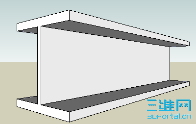

MATS(平台或垫)由7根BSI BS4-1普通H钢制成.
