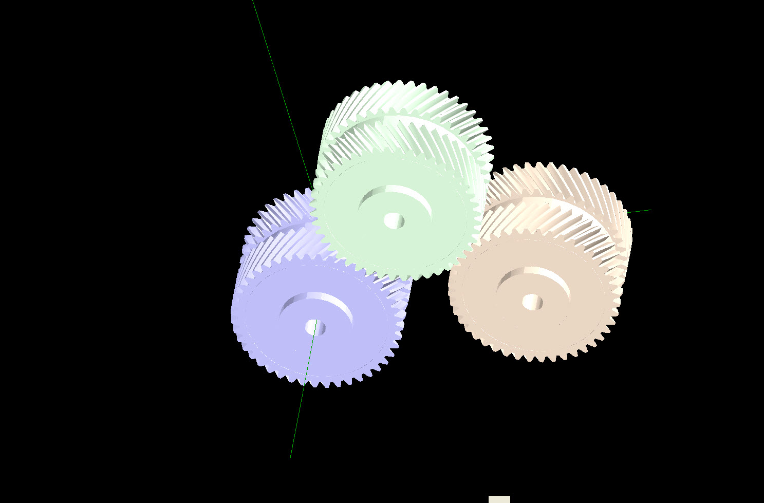

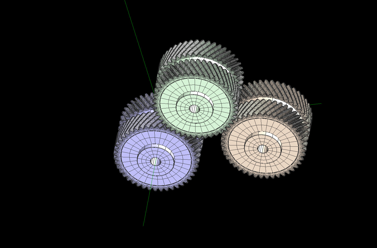

i modeled the herringbone gear as follow:
, `- w. z* @0 G(a) a finite element model3 k4 y  S1 T7 |
2 V' ?7 m- i8 B& g! r- W* H- b  m* M1 w1 H% |
(b) a model with herringbone  e2 c2 Q6 Z# ^; N/ `' e
2009-11-6 9-22-22.jpg . P$ s7 Z( t! W9 M7 Y8 o+ n
% j7 C9 e: G2 ?$ `. R% y8 k* y

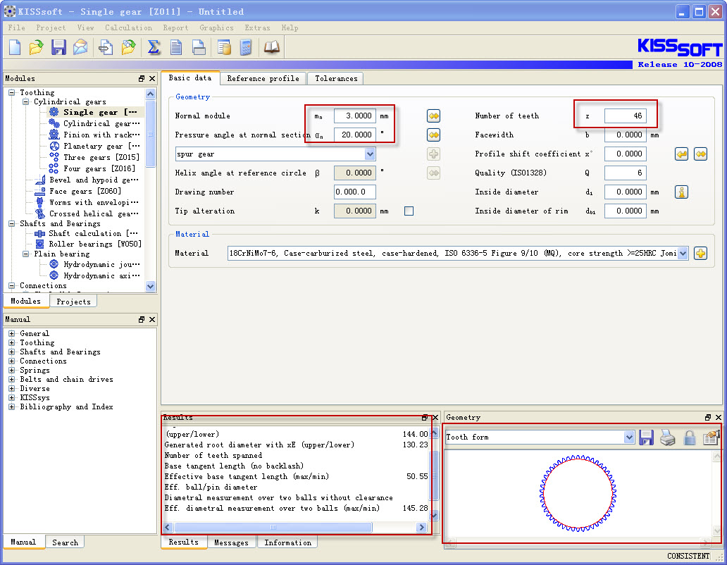

& P" Y8 B$ ?4 P) `. YIn addition, KISSsoft can build up the model with parameters of m、alpha、z, and you can  export the model to sw,pro/e,ug,catia,think3,inventor,solidedge. but you need to provide more parameters in ansol
