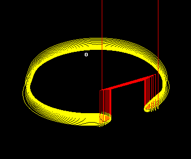

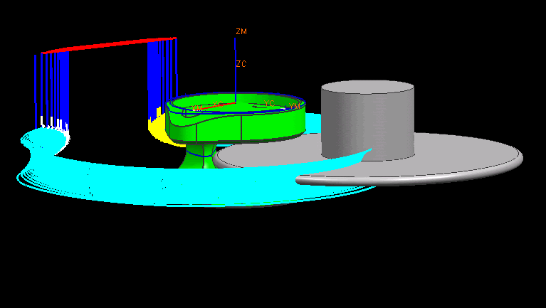

发表于 2009-11-28 12:26:18 | 显示全部楼层 来自: 中国台湾
用T形刀加工倒勾部份6 {. [1 Q6 e5 M9 E! L
http://i15.photobucket.com/albums/a360/andy14148/Snap1-9.gif! n: B6 O+ o: I$ S7 ?) i
# y+ s/ _6 Q6 a% `
後處理出來的G碼) G9 r$ D  H3 z7 ]. a/ H. {, r
& v0 Z0 Y( E1 T" e; a: s
http://i15.photobucket.com/albums/a360/andy14148/Snap2-1.gif
' _5 r6 m7 t% d3 W0 t3 d& {" ]* _; `" @8 B/ g# q- R# Y
類似熊族的路徑查看器,當然不是熊族啦. q2 [/ r3 I6 o' E
" I* C# }7 F( g: Y; Y' Xhttp://i15.photobucket.com/albums/a360/andy14148/Snap3.gif
: U- Y! D. E2 ~7 N8 C9 v; q
: i7 G' E! w! Y8 ?, W加工一些倒勾還免強可以勝任
