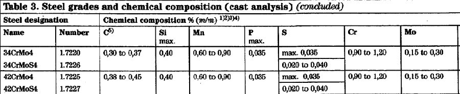

这几天接受到一个42CrMoS4的材质,在DIN 17200标准里面有所记载,我仔细对比了一下42CrMo4的化学成分,含量是一样的!请问那个大侠能给我个解释,里面的S代表什么意思?按照材质号的表示方法,我个人理解应该是硫含量的变动问题!请高手赐教!!!!

实质上是一种易切钢,也就是含硫易切钢

42CrMo4, 42CrMoS4 Steels   , P& K0 U# T1 u. O9 ]
   , o) V2 o4 Z9 l
    % h( c2 D: e% q9 m9 ~
   Steel name: 42CrMo4, 42CrMoS4! _: b3 [( }, c, I/ I$ o% ?
  Diagram No.: 3377* `! E% a: E  H' O
  Type of diagram: TTT
$ I  u9 \5 m9 V+ X( x  Mat. No. (Wr. Nr.): 1.7225, 1.72270 }* X& v8 s  A& y& l. u( N( R
  DIN: 42CrMo4, 42CrMoS4* f/ T1 l3 P5 }/ w4 e- V
  SAE: 4140H, 4140RH
5 T! H8 d' k0 H! o+ y  Old name: Mo4
# g! N# z6 t% e; O" g3 l$ n9 V# j  Chemical composition in weight %: " R% d- M/ h3 I( o$ j7 @/ Y* g
42CrMo4: 0.42% C, 0.25% Si, 0.75% Mn, 1.10% Cr,  0.22% Mo, <0.035% S, (Pb).
$ l+ J, e. M  y; [+ H42CrMoS4: 0.42% C, 0.25% Si, 0.75% Mn, 1.10% Cr,  0.22% Mo,0.020-0.035% S, (Pb).
) d! R5 {: ?1 J: ~! d  Note: Alloyed steel. Austenitized at 850 oC.5 u" B6 L9 l! [& `  t3 i
  Source: Website Saarstahl AG, Germany, 2007.. ]/ n: T# \/ d1 h9 G( |  v
s的含量是不同的
