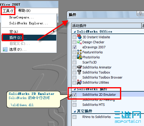

请将下图示插件关闭就好:7 z/ z7 Z( Q( {' D/ H% v
" @& d4 ^) x( z! C: t- ]9 W 1.png
