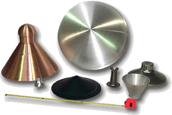

旋压是把工件挤压成型工艺的一种,一般把低碳钢等延展性好的材料,在旋转过程中,把成形选头挤入材料中,获得所需的形状,汽车皮带轮、灯具等行业使用广泛。
发表于 2008-10-31 15:02:42 | 显示全部楼层 来自: 中国重庆
What is Metal Spinning?: A metal disc blank or pre-form that is produced by drawing or stamping is concentrically clamped against the spinning mandrel/chuck by the pressurized tailstock. The main spindle then starts to rotate while a spinning roller makes frictional contact progressively reforming the original blank or perform until the metal lies internally on the spinning chuck.
