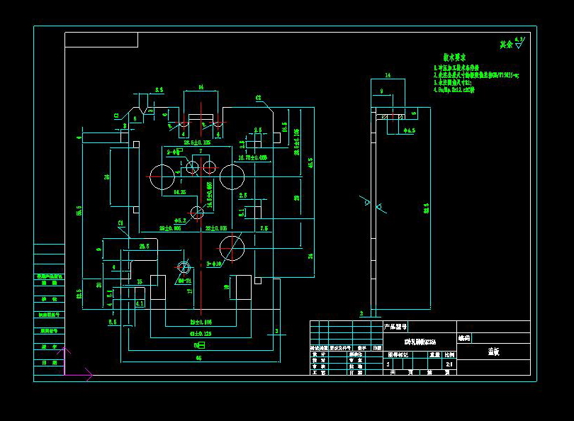

Generically, design engineer  do not need to release unfolded drawing, if you are manufacturing engineer, it is necessory for you to release unfolder drawing. Unfolded drawing can be gotten according bending table, or bending factor, which may be different with different bending machine.

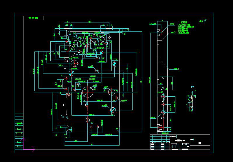

发表于 2008-12-22 22:32:16 | 显示全部楼层 来自: 中国北京
明天我拿一张我画的钣金件的图纸来给大家看吧。件已经模具批量生产了,而且车间反应不错的。
发表于 2008-12-24 21:00:34 | 显示全部楼层 来自: 中国北京
接上面的,带了张钣金的图过来,博高手一笑,给初学者一点参考。
发表于 2008-12-24 22:29:58 | 显示全部楼层 来自: 中国北京
顺便说一句,我单位cad图纸打印是按颜色区分的,白色线打出来是粗线,0.5-0.7宽;190的淡紫色是粗点划线,0.3宽;其他颜色是细线,0.13宽。希望大家看到图之后别犯晕~
