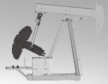

简单模型在设置运动后仿真出现错误,无法找到初始位置:
4 F# I5 I4 Y9 I0 H. XThe Initial Conditions displacement solution failed.  ADAMS/Solver could not determine the initial assembled position configuration of the model.
, _" P4 _9 S# |9 r+ L" `1)Try increasing the number of iterations for convergence.  Current value: 25.
# V( X% A" [& K1 P9 A3 D2)If redundant constraints are present try to eliminate as many as possible.6 _; ^$ X4 e0 [
3)Make sure prescribed motions are consistent with other aspects of the current model position.$ L/ m0 I! }, B, B( L/ C3 Q3 T
4)Check to see if joints are inconsistent (contradictory); eliminate them if so.! l, j: L% s* b/ s" y
5)Check to see if parts are not too distant from an assembled configuration.! Z6 V% N* S( z2 J  Q/ R8 F
0 X0 t( C7 [& d+ u+ u; o曲柄处设置圆周运动,底座固定,无论z,x轴在底座上怎么设置,仿真都出现问题。。。但将曲柄旋转中心左移到底座左侧以外就可以仿真 ;) ;) 新手不懂,请教。。。: _% W( c1 g3 a5 V

建议你检查你的模型配合是否出错,从新装配,装配时先把左侧驱动结构装上,再装配从动结构
