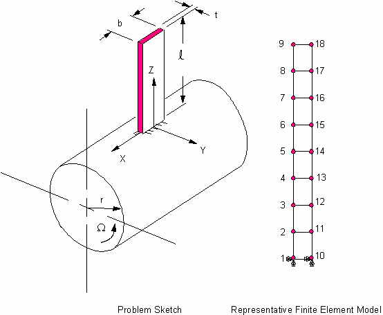

提示:如果分析得出第一阶频率接近72.059就可以了,因为CosmosWorks(2006)在频率分析时没有办法设置旋转刚度软化的影响,所以不会得到后面那个target值。

A blade is cantilevered from a rigid rotating cylinder. Determine the fundamental frequency of vibration of the blade, f, when the cylinder is spinning at a rate of Ω .) g4 [9 }: K! C9 ~; I, v0 ^
0 p7 g- ]- Q5 o) eFigure 54.1  Rotating Cantilever Blade

Material Properties
E = 217 E9 Pa
ρ = 7850 kg/m3
υ = 0.3
Geometric Properties
r = 150 mm
l= 328 mm
b = 28 mm
t = 3mm
Loading
Ω = 100π rad/sec
% q2 m+ y1 [* Y7 E
Analysis Assumptions and Modeling NotesThe problem is solved in two different ways:
, D" g, x1 k6 I( e. _6 S
  • Using Elastic Shell Elements (SHELL63)
  • Using 3-D Solid Shell Elements (SOLSH190)
2 c) E1 b  M' LSpin (centrifugal) softening is used. Since the cylinder is rigid, the base of the blade has its displacements constrained. A static prestress analysis is performed to include the inertial effects resulting from the rotation of the cylinder.

9 U$ j4 z! [8 h, XResults Comparison3 l6 U8 O5 l) L2 q# S
8 M  g0 E* d4 A( H( a0 b
TargetANSYSRatio
SHELL63
f, Hz52.7552.010.986
SOLSH190
f, Hz52.7551.800.982

都不考虑旋转刚度软化的情况下,在偶的机器上CosmosWorks是72.059,ANSYS是72.060。
