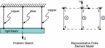

Reference:S. Timoshenko, Strength of Material, Part I, Elementary Theory and Problems, 3rd Edition, D. Van Nostrand Co., Inc., New York, NY, 1955, pg. 30, problem 9.
Analysis Type(s):Static, Thermal Stress Analysis
7 N2 W. d5 w# Y" ]# WTest Case7 N# `2 W% p. e
$ y& g! C& X7 N; c8 A* LFind the stresses in the copper and steel wire structure shown below. The wires have a cross-sectional area of A. The structure is subjected to a load Q and a temperature rise of ΔT after assembly.
  D$ t1 p8 W- Y3 q0 n. S8 C; @6 R: B
1 m  T3 f) S1 W( s3 ^- c$ y9 oFigure 3.1  Support Structure Problem Sketch1 D" \. r$ A, M/ M
2 p  d6 S, C+ p- S" y8 W VM3.jpg 4 \" [" u; O# u- F

1 @* s7 g, z6 D( R7 N* I8 A9 XAnalysis Assumptions and Modeling NotesLength of wires (20 in.), spacing between wires (10 in.), and the reference temperature (70°F) are arbitrarily selected. The rigid lower beam is modeled by nodal coupling. 5 g) U/ A3 \" `' h
6 ?  V3 H" P" Z- C) m' ?- k
Results Comparison
TargetANSYSRatio
Stress in steel, psi19,695.19,695.1.000
Stress in copper, psi10,152.10,152.1.000
