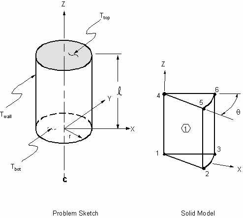

提示:已知一个圆柱体的顶面温度和侧面、底面温度,求温度分布。

Title      Temperature Distribution in a Short, Solid Cylinder

A short, solid cylinder is subjected to the surface temperatures shown. Determine the temperature distribution within the cylinder2 Y  m$ S, r' s/ c6 v$ d
- ?9 N; L1 ^1 N" a5 s/ m+ Z* D3 |
Figure 96.1  Short, Solid Cylinder Problem Sketch9 C+ F- @. k: [& c

Material Properties
k = 1.0 Btu/hr-ft-°F
Geometric Properties
r =l= 0.5 ft
Loading
Ttop = 40°F
Tbot = Twall = 0°F
; i. u( R3 K2 z, W# R' Z1 J, k/ @+ T$ s0 o7 L. E/ y! z# E

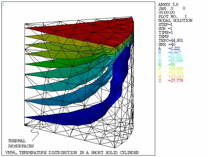

Analysis Assumptions and Modeling NotesSince the problem is axisymmetric, the entire cylinder geometry is not required. An angle Θ = 45° is arbitrarily chosen. Postprocessing is used to print temperatures at the centerline in geometric order. A finer mesh density (than required for reasonable results) is used to produce a smooth isosurface plot.0 H1 b7 i3 S- k8 y! i. i. q7 c# n. ^' o

Results Comparison
At CenterlineTargetANSYSRatio
z = 0.0 ftT, °F0.00.0--
z = 0.125 ftT, °F6.86.81.007
z = 0.25 ftT, °F15.615.40.984
z = 0.375 ftT, °F26.826.60.991
z = 0.5 ftT, °F40.040.01.00
4 m7 f8 t  E+ u. s3 e0 ?, L
Figure 96.2  Temperature Isosurface Display with Annotation
