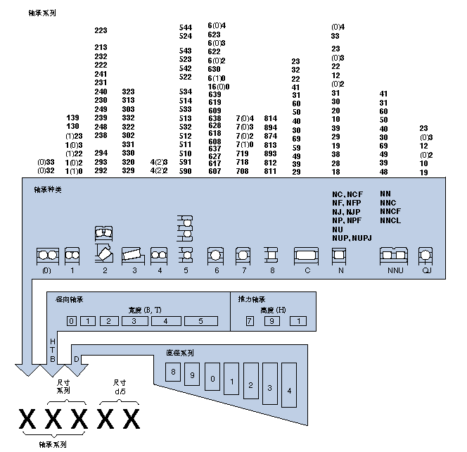

发表于 2007-5-14 23:58:02 | 显示全部楼层 来自: 中国河北邢台
http://www.skf.com/portal/skf/home/products?paf_dm=sharedmaincatalogue=1&lang=zh&newlink=1_0_61
6 T1 c* d+ Q# D  S1 J. d" T! S( F# N& V, _$ _7 N5 U
http://www.skf.com/skf/productcatalogue/jsp/viewers/imageViewerJs.jsp?image=0007f07.gif&file=1_0_61&maincatalogue=1&lang=zh/ _& o- p# Q4 L* l
9 @9 Y" s# E& \, r; L" E' Z
SKF 标准公制球轴承及滚子轴承编号系统
