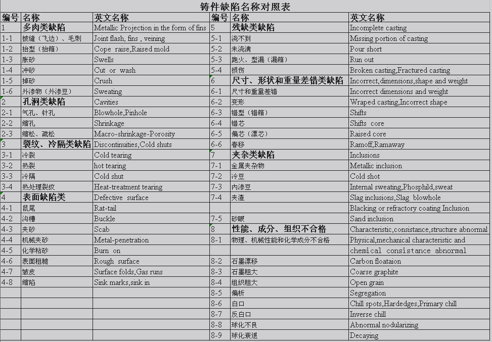

铸件缺陷名称对照表                                        , V  T! a, _% O. Z
编号        名称        英文名称        编号        名称        英文名称- _+ y; w+ s8 f* u% A; Q6 T; b
1        多肉类缺陷        Metallic Projection in the form of fins        5        残缺类缺陷        Incomplete casting
' V! `# b+ R7 m2 B" P, `1-1        披缝(飞边)、毛刺        Joint flash, fins , veining        5-1        浇不到        Missing portion of casting
# u7 E' g1 F! ^1-2        抬型(抬箱)        Cope  raise,Raised mold        5-2        未浇满        Pour short
( W# ~& g2 I4 X1-3        胀砂        Swells        5-3        跑火、型漏(漏箱)        Run out' n& R& e6 o: D. M' ~
1-4        冲砂        Cut  or  wash        5-4        损伤        Broken casting,Fractured casting) w( I+ I# h, R4 m+ w# a
1-5        掉砂        Crush        6        尺寸、形状和重量差错类缺陷        Incorrect,dimensions,shape and weight
6 N0 |6 H' I5 @. l, L1-6        外渗物(外渗豆)        Sweating        6-1        尺寸和重量差错        Incorrect dimensions and weight
, _5 |3 p6 b2 t! N( W2        孔洞类缺陷        Cavities        6-2        变形        Wraped casting,Incorrect shape
+ ~; r  H$ i$ |3 F7 W2-1        气孔、针孔        Blowhole,Pinhole        6-3        错型(错箱)        Shifts
0 e: f/ y! G/ [2 m2-2        缩孔        Shrinkage        6-4        错芯        Shifts  core
8 [; p* C5 r" K) V2-3        缩松、疏松        Macro-shrinkage-Porosity        6-5        偏芯(漂芯)        Raised core/ p) L, L  r# ]5 c" s. s6 H' }$ J
3        裂纹、冷隔类缺陷        Discontinuities,Cold shuts        6-6        春移        Ramoff,Ramaway
+ m  S; j3 q! P- u: a0 y3-1        冷裂        Cold tearing        7        夹杂类缺陷        Inclusions  [  h8 h, Q$ s2 X0 `4 n$ ~1 n4 I
3-2        热裂        hot tearing        7-1        金属夹杂物        Metallic inclusion
1 o7 Z9 ^. T& P. z3-3        冷隔        Cold shut        7-2        冷豆        Cold shot- ?  v, T6 |- L8 i+ t
3-4        热处理裂纹        Heat-treatment tearing        7-3        内渗豆        Internal sweating,Phosphild,sweat
& n; ^9 e- Z" t6 }6 E# [, Q& v4 r4        表面缺陷类        Defective  surface        7-4        夹渣        Slag inclusions,Slag  blowhole4 x3 e7 y+ g. I' I. d
4-1        鼠尾        Rat-tail                        Blacking or refractory coating Inclusion3 c' e# X; e  H2 [  K  A  l& c
4-2        沟槽        Buckle        7-5        砂眼        Sand inclusion
0 i: N! A. g  q  F4-3        夹砂        Scab        8        性能、成分、组织不合格        Characteristic,consistance,structure abnormal1 v1 l9 N: v% n( Y+ n) R/ G
4-4        机械夹砂        Metal-penetration        8-1        物理、机械性能和化学成分不合格        Physical,mechanical characteristic and
! H; C% c" ~) z+ B4-5        化学粘砂        Burn  on                        chemical consistance abnormal6 a) d3 v8 h: U9 m" t9 j& Y
4-6        表面粗糙        Rough  surface        8-2        石墨漂移        Carbon floataion
% H. S9 J( |5 ]/ y7 l) A4-7        皱皮        Surface folds,Gas runs        8-3        石墨粗大        Coarse graphite  _) o; g1 w' @% I" n+ R& f
4-8        缩陷        Sink marks,sink in        8-4        组织粗大        Open grain
" c: ^: e- r; X. s2 [' H  [4 {( f                        8-5        偏析        Segregation# q, k3 V' O/ _  C) a# b9 W7 y
                        8-6        白口        Chill spots,Hardedges,Primary chill. ~; \( B) X9 `5 S
                        8-7        反白口        Inverse chill2 ?7 }  E2 Q4 j5 @( E
                        8-8        球化不良        Abnormal nodularizing4 p- s9 j  X6 ^: u  @( s+ \
                        8-9        球化衰退        Decaying

总结一下
* N; s$ b; Y3 {  ]9 g1 }% G; a0 I# `& z2 o
铸造缺陷库: y  C* ?7 {( I3 D4 A
" C2 c( Y* E! S0 x$ f: {! q" f
1 多肉类  Metallic Projection in the form of fins
, M- m* y+ D: k' ?  w" Z2 孔洞类  Cavities
  S7 D. X  l) M+ `3 裂纹与冷隔类  Discontinuities,Cold shuts5 d. }' q$ y9 h% @7 P
4 表面类  Defective  surface
9 v! N' C6 H# A0 Q% Q5 残缺类  Incomplete casting: D  U6 J! N. w& F# h7 B
6 尺寸、形状和质量差错类  Incorrect,dimensions,shape and weight& b; B( [9 c# Q, m7 `, U2 E
7 夹杂类  Inclusions
! ^/ \  V: [! G9 |; r4 K) H( N8 性能、成分和组织不合格类  Characteristic,consistance,structure abnormal: k- K% H. X0 _' ]$ h
0 `/ h0 q! n9 x# }8 j& i
( v  t6 S) Y9 M7 m& K*多肉类$ A* \+ q5 }/ p8 W, x
; R$ H7 d$ G6 i, z5 P, B
1 披缝  Joint flash# y- I5 j: K  d. ]3 G( g
2 毛刺  veining. R: w% X/ W! W! K2 ~
3 抬箱  Raised mold
2 y% @2 a, S: c2 U4 胀砂  Swells; t$ Y, G5 y* Z: m: y( Y/ ~: |
5 冲砂  Cut  or  wash: A$ l% X4 I3 c) e' @% U
6 掉砂  Crush
6 I, T$ q2 U7 t7 外渗物  Sweating
7 @+ I1 E, E; L×××××××××××××××
- F- \+ C+ G  D; G! T! @+ c. w# x- ?  e3 {/ v; N2 S
*孔洞类* N$ I# n4 ^% X- U" u' V
5 s8 g! F+ I. W! J4 m8 E$ F1 气孔、针孔  Blowhole,Pinhole( k" y& a' m0 }# f- }  s
2 缩孔、缩松  Macro-shrinkage-Porosity
1 ^6 p& C4 d8 y1 Z, C1 f. \. d7 ^; X- I, m
5 E) E7 R: m  q. Y( C1 w, O6 {8 l# k* T5 M2 H1 \2 R# H
*裂纹与冷隔类
" x& i% ?2 A( _; D1 Q; s5 ^& c; W- t% B0 \9 Z6 E( e
1 冷裂 Cold tearing! ]& N3 e+ T" y. k( X
2 热裂 hot tearing
+ Z( E* \& g/ s* B: v2 R% \3 冷隔  Cold shut& s: j* y+ j0 F; c6 E3 s, m
6 |' T- }: a' Q! M1 K: _+ {# d( M( o0 O& u& y6 V# s+ n
- R$ V3 {5 d4 r) Y# N5 n
# x6 L4 o7 i, ~  C' Z*表面类
" z( [1 O6 k* @* |7 `6 J, }# E+ o: R* ~- {
1 沟槽 Buckle
$ j7 t! X3 j+ F1 D4 p3 f/ A6 _2 鼠尾 Rat-tail' f6 e& q2 }: `* H% c, i
3 夹砂结疤 Scab. X" [$ W4 _! P/ P7 P
4 机械粘砂 Metal-penetration/ u. \9 H$ q7 B8 `0 t
5 皱皮  Surface folds,Gas runs: k2 ^/ j7 t" [
6 化学粘砂 Burn  on  chemical consistance abnormal
. d/ F4 |- L/ i5 s( l3 I* m; W7 表面粗糙 Rough  surface
% X+ V# ~# D* y1 z8 缩陷  Sink marks,sink in7 J6 [8 }6 ]# R# N3 w3 ~* o
9 D9 g' l$ ]) B9 A% x  O
% r* C) Q* v7 |/ c' m( f. n; S
* o; e) y  o. `*残缺类
& T: o5 _# t- |5 C5 G! ?8 I3 s  h! }5 {
1 浇不足 Missing portion of casting
# N/ ]3 T; B' F% F3 f2 未浇满 Pour short. p# z* J) C, C  b+ D2 w, S7 T
3 型漏   Run out
# Z) `' V: e( G4 损伤   Broken casting,Fractured casting
$ |& I' ^8 q& W, a1 Y# n" {- d1 `& L( A0 {
0 p' c; Z  p- E7 R. b& Y
: f* z# b! i/ Y9 c8 ^*尺寸、形状和质量差错类& a, q/ a' ~) s
, c9 G( D  C3 F+ h* \  f, h7 M( {1 尺寸和质量差错 Incorrect dimensions and weight
# W- v4 `0 e1 d7 H, Z- u5 @7 |2 变形 Wraped casting,Incorrect shape1 Z6 P, Z  c  c
3 错型 Shifts
+ f8 }3 P& j' W4 错芯 Shifts  core( |# T* G& p6 h! R2 p" b- Y
5 偏芯 Raised core- y' G' x! C9 A; g5 A
6 捣移 Ramaway$ R( ]6 C" t. h& m4 K( ?& A
$ V3 T3 v, u. ~7 F) i8 Z& m2 U% ]
×××××××××××××××4 q8 ]6 c" Z- l7 B8 L
" u8 ^( M, i$ ^- l' G" O*夹杂类
! A. ]& j+ x3 b) i$ b0 Y* G1 ^- c9 ^0 v: W! {
# x- [2 T2 o0 m  |# V0 V2 冷豆 Cold shot& C% x: q  k, p4 h
3 内渗豆 Internal sweating5 I1 b1 O  `- L+ n9 q
0 i4 ?. f7 p5 a1 q* s/ f0 J5 砂眼 Sand inclusion8 i% F7 z1 v0 R3 s6 O& p) H
3 W) N  ~- Z- [- }! r/ W
×××××××××××××××3 p8 t, ~3 C3 L, m  n' R6 T
0 g2 L8 o( y0 ^8 v
*性能、成分和组织不合格类0 C6 k& X- |- F1 M! q
, R3 _8 a% U* y4 U% \
1 物理、力学性能和化学成分不合格 Physical,mechanical characteristic and chemical consistance abnormal8 G8 y5 g0 v2 d! F! q
2 石墨漂浮 Carbon floataion
; ?" m% V" {2 O6 K# U3 石墨粗大 Coarse graphite
6 t# S5 l9 m6 _9 j1 [4 偏析  Segregation
) \0 ]* E9 N% P6 l2 T. ~; j5 组织粗大  Open grain
# H- D: ?0 l- n* B/ c, h4 S6 白口  Chill spots,Hardedges,Primary chill
8 W, _+ p( x6 u) v3 [7 反白口  Inverse chill& b/ V/ q9 Z1 ]9 W7 R- g
8 球化衰退  Decaying
3 [5 w3 V! k& @" d, F
+ N' p& T% s+ E6 }0 c0 z××××××××××××××××

发表于 2008-10-17 16:49:43 | 显示全部楼层 来自: 中国江苏苏州
楼主的附件内容如下图
