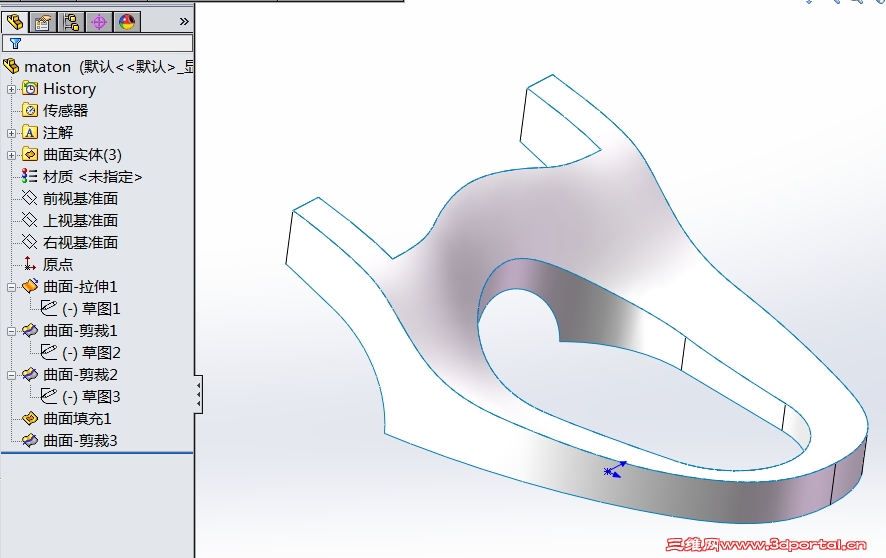

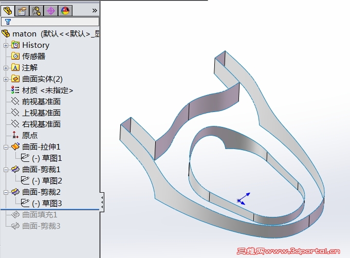

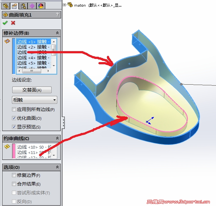

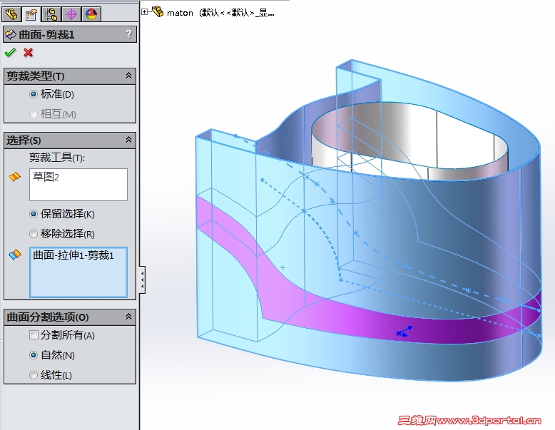

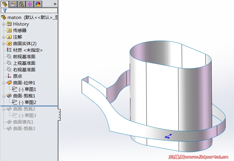

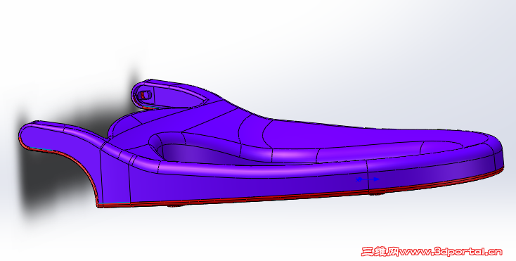

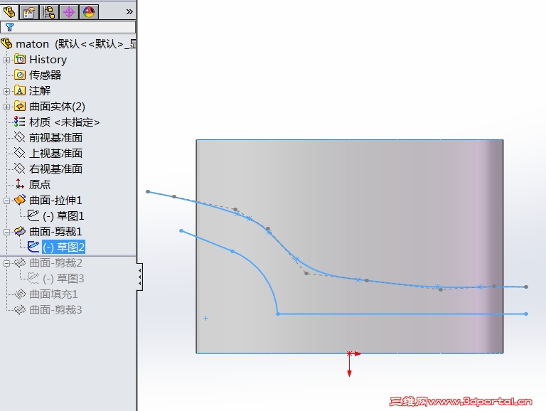

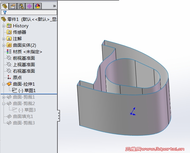

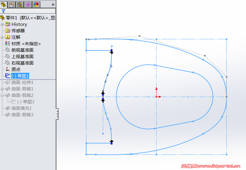

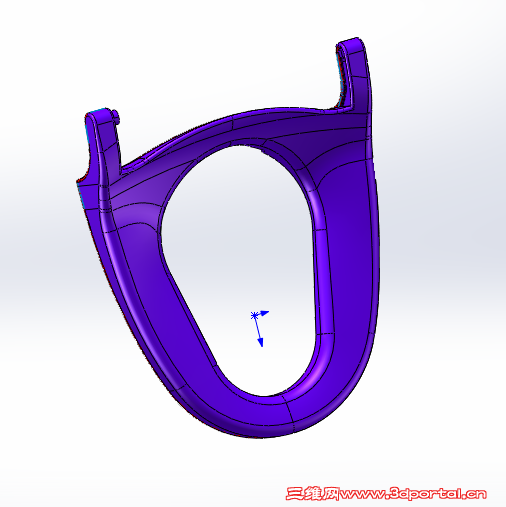

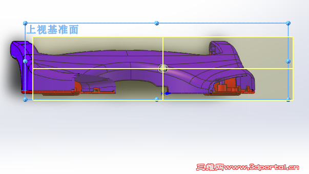

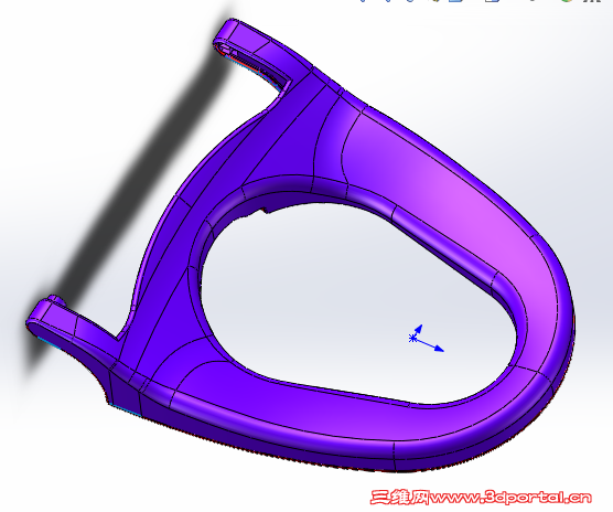

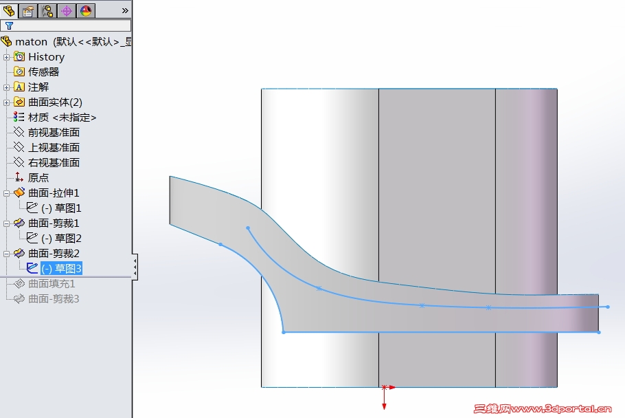

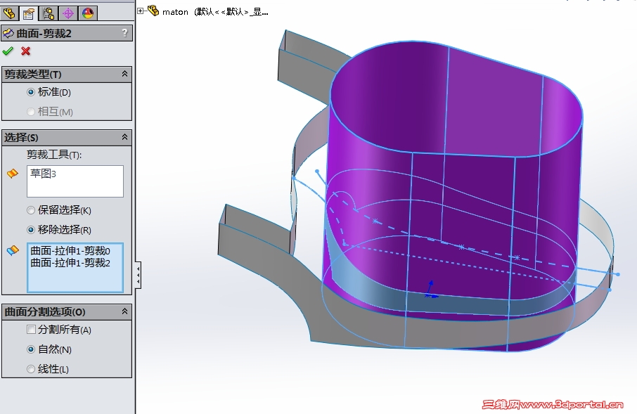

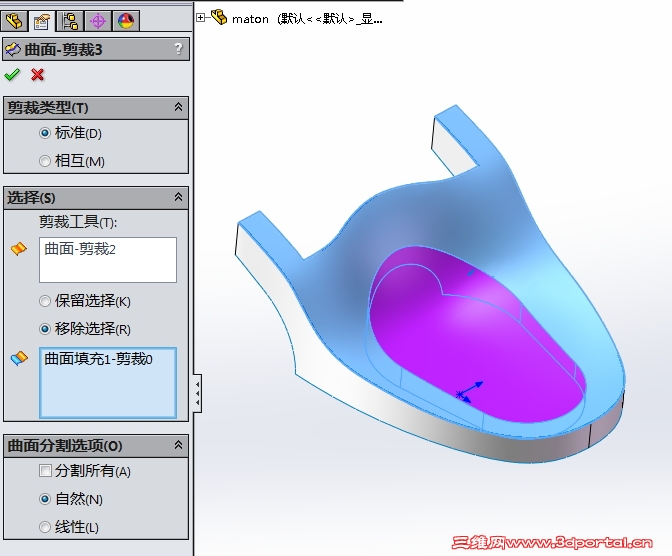

" D7 X2 H7 B( u/ T! |+ H/ [ maton2.jpg , l1 k8 I6 }& X8 z1 |
1 x6 e( c9 A# R4 G# c  S maton4.jpg * M7 H; x' h- N
: p9 K* G% `) I maton6.jpg
5 T; J# f0 i/ c/ Y. T maton10.jpg 3 I7 k' _4 P! Z* D1 m, R) v
( N& B3 \5 `: M" N3 W% ]0 Q
maton11.jpg ! Q: r/ A2 Y' R$ I
3 ]6 g2 u5 [9 z, N8 q( [+ L" h
3 |& d; k" C5 C
6 a7 p4 @- Q% j* T4 B9 Q; N7 P % c2 ?8 |- L9 ?$ e+ k9 \0 {; r
" E( L7 R, e' O% d, m& v ! ~% i7 I" _' F0 s8 \$ A
( v' W7 b7 I) ]9 t
5 a* w$ Y  A$ R. |" ~7 s* ^
+ W) h& B( b. }2 Y* y. D" f* }4 F4 B5 x0 Q+ s/ S5 m: h
