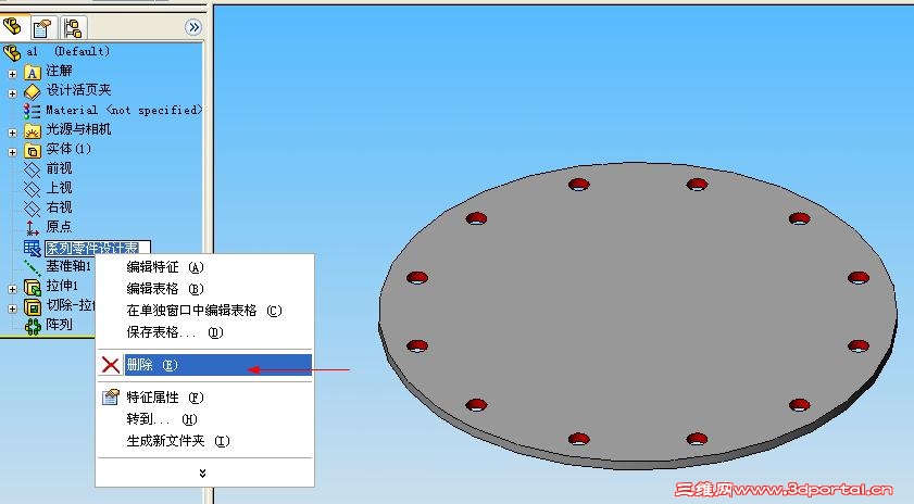

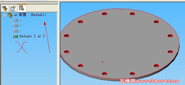

删除系列零件设计表如图所示。
2 U# t7 H  G  w* w' c$ X* |4 q- m; W2 U$ U2 s
7 ~8 d% F6 J$ b" `3 }2 g" @0 |
# N7 H" `5 `: [5 t# n右键删除配置
, {# J- H; w) X! k' I% v- ~. p

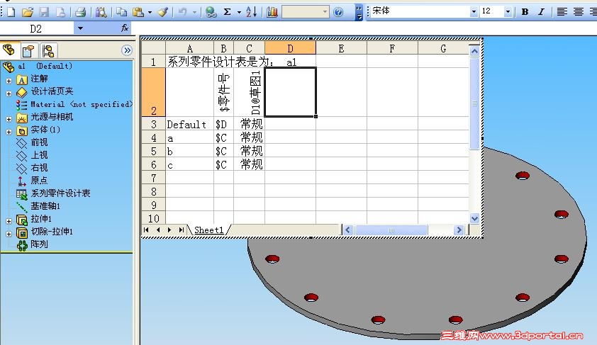

8 U# j/ O$ u3 s- R% ?- x用VBA完成上图代码如下
! R/ f" ?0 |! o0 QSub lll()
3 G% m) m# u: V# X  R- ?  Dim SwModel As ModelDoc2  e/ `# T8 b  X* x! D* X
  Set SwModel = Application.SldWorks.ActiveDoc
+ t/ T) b8 _% W$ Z$ i+ _) Z  Debug.Print SwModel.GetTitle8 d$ W4 J' [2 |2 }, F
  With SwModel
# R7 q' Q3 f, b/ b( K    ss = .GetConfigurationNames
2 [3 h/ T8 @9 l9 P    ' .ShowConfiguration "b"- a3 j' {3 w3 n9 T, R' n& I9 K
    '.DeleteConfiguration "c"
. i$ e5 D+ Y" S6 f4 Y9 W    For ii = UBound(ss) To 0 Step -1
( |& \& C. h" ^5 c4 O6 E2 \       Stop
: X% c/ h3 J5 t) y0 o! s       .DeleteConfiguration ss(ii); \5 w* j: D. J. O" C9 M
       Stop, j. e$ u) {! D  h, b  F# ?
    Next ii
* D, K; F0 W& H$ F' I1 J9 i$ c  End With
# S( @; g+ d$ i& S! T2 bEnd Sub( E# s& \6 ^8 B" l2 v4 j
