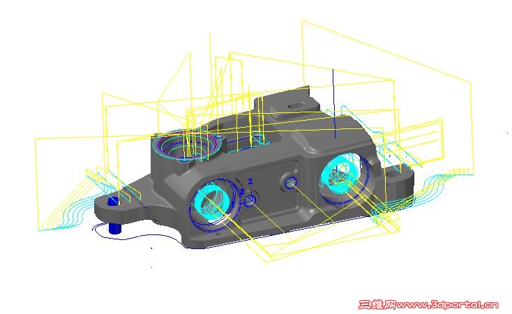

[原创] 五轴森精机NMV3000 用mastercam编程及后处理
发表于 2012-11-17 19:24:25 | 显示全部楼层 |阅读模式 来自: 中国江苏苏州
附图.JPG % ^: Q) Z* G* x9 Y
5 ?6 ~1 p  ~* ?4 e, {, L
% R& @0 k2 `" S7 }8 W6 J0 t6 B
: @6 I/ N! O5 D4 @) q# H$ ^程序(中间一部分,有角度旋转的)2 l3 C5 M$ |2 H" B% K! D: F

G3 X-10.07 Y-29.569 J2.! a0 }5 [" G5 S' v) j
I-6.735 g, z5 k" |8 n
X-12.07 Y-27.569 I-2.
! j% z+ t2 t( L2 S& LG1 G40 X-14.076 l$ x) ^% c1 E" P$ \/ B) D
G0 Z80.
# k# n. }* \3 [; x# RX-16.644 Y-29.565
! i! o3 g) Y; C( A9 e* G! RZ20.779
. B  A: w( t) vG1 Z14.779 F763.8+ Y/ h+ {. A4 @# U! `
G41 D11 X-19.144 Y-27.905 F800.0 f7 C& w$ i5 z* S7 w% @
G3 X-23.011 Y-30.267 I-1.383 J-2.083
  R+ f, K) h& |9 u5 H6 Z5 J- I% p, [I6.211 J.698# Y. N3 T6 d- a# s
X-18.716 Y-31.712 I2.484 J.2790 z" ~  m4 {5 J! e
G1 G40 X-16.647 Y-29.539; R9 V0 ]! B1 Y, t* l3 s
G0 Z80.
( S+ V) f/ j) s2 |0 F4 y' bM9# _# @' L# t0 |6 s* H- W- c, J0 [8 V
M5. t- z# h/ _4 L
G91 G28 Z0.
/ k% U" Z) {+ b5 G; @7 oG28 X0. Y0.
0 [7 i* u5 G1 h, p; u" GM01
$ k, M& F7 t5 {) E8 ]9 \3 p' G& Z(D12 T_MILL |TOOL - 17|DIA. OFF. - 17|LEN. - 17|TOOL DIA. - 12.)
/ g, l) u& R3 \' D7 nT17 M66; \& N' s3 Q5 H2 W& Y
M69 M111 `3 L/ v0 [! L' ?, {
G0 G90 C180. B90.$ d( \: t* @+ T8 Z; Y1 ?. \0 Y
M68 M10- c# Y; ^0 {; r! J! @* ^
G65 P9681 X0. Y0. Z0. C180. B90. M54. Q59.
" j4 A0 q, U1 Z7 vG0 G59 G90 X-17.106 Y-29.569 S5000 M3
7 k. p4 h3 Y, e6 zT18, `. w8 u0 J3 M
G43 H17 Z80. M80 E* }$ z% h! C0 R. y$ Q4 q2 M
Z26.278- z- J! H2 v/ e  f
G1 Z20.278 F763.8% o$ D  O7 l$ k2 ~2 ]2 T
G41 D17 X-15.338 Y-31.337 F400.' l: Y$ C$ A0 Y; }9 K; a
G3 X-11.07 Y-29.569 I1.768 J1.768) o) B# f, T+ M9 v& m
I-5.730 p1 {& i% |; I- ?$ S. s4 Z
X-15.338 Y-27.801 I-2.59 Q7 x: K0 s& Z" O- p
G1 G40 X-17.106 Y-29.569
6 `' @% r) e& A5 kG0 Z80.
2 r$ Q, A5 V2 P. cM9  k4 |/ t# i* J! G
M5) |& \0 Q7 i' k% _7 H1 C
G91 G28 Z0.1 z6 q. m- c& @: ]/ `$ T/ ~
G28 X0. Y0.& j7 W+ X& _/ C3 Q
M01. m$ W) A* p, Q( P/ i
(D10 THREAD MILL |TOOL - 18|DIA. OFF. - 18|LEN. - 18|TOOL DIA. - 10.)
7 |: [4 k* ^, ?) bT18 M66
, a3 @2 z3 `2 |M69 M11
* {' n8 D0 i$ S! T$ F" bG0 G90 C180. B90.
* Y+ D8 |7 Y2 o* m7 f8 E, CM68 M107 D  z4 P4 F0 E1 \
G65 P9681 X0. Y0. Z0. C180. B90. M54. Q59.8 \6 [5 p+ M( Q2 |0 b# P6 x" H
G0 G59 G90 X-16.8 Y-29.569 S6000 M33 h/ A! `/ b- R) H  X
T8. c1 n1 Z1 `0 q
G43 H18 Z80. M88 Q0 r# y9 ^2 |5 r  w
Z26.778
) W% ]" V- f7 O& Z# _3 a, ?: H5 kG1 Z20.778 F500.
# M# S; E7 d) p% p6 k  iG41 D18 X-13.07% F0 M9 L- h. C$ l" c
G3 X-16.8 Y-22.84 Z20.903 I-3.73 J2.331+ c+ O$ _# [( p! M: d
Z21.403 J-6.729
1 Q1 U) n) g9 Z  K# W9 }Z21.903 J-6.729- k/ D/ \/ I* F5 E
Z22.403 J-6.729

) ~* G+ g4 d5 o看附件吧,里边有详细的说明,具体我就不讲了!
0 U* J4 d4 E9 u 基于MasterCAM的三大类型五轴机床后处理程序编制方法.pdf (558.16 KB, 下载次数: 505)

 楼主| 发表于 2012-11-22 20:20:27 | 显示全部楼层 来自: 中国江苏苏州
l720 发表于 2012-11-19 16:13 static/image/common/back.gif6 f' Q5 M" v/ F, }2 ~5 K, [" Z
9681程序是否可用共享!谢谢!
( M% N0 P8 o/ n4 j
森精机自带的,别的机床用不了吧,宏程序设计到很多机床参数。
