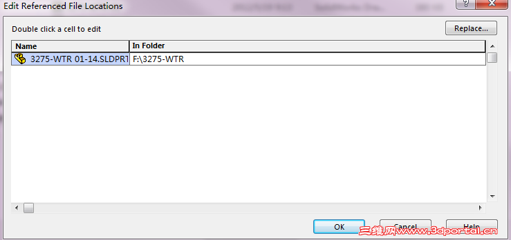

我的电脑是WIN7 64位旗舰版本的,安装SW2009 SP0.0的时候 点打开-图纸-参考-双击文件名称是可以浏览替换掉这个文件的,可以升级成SP5.0的时候双击却无效了,只能自己输入文件的名称,请问这是怎么回事?

我自己的在网上找到答案了
3 S; G# T$ }' n6 o8 n: ~; _Re: SW2009 SP5.0: Cannot use "Edit Referenced File Locations" dialog
- l. ^9 t8 N0 Q/ SSo Jim,) U4 o: p' `" @
We just need to use the Ctrl key with the double click to get the old behaviour..4 N7 h- Y' Q' ?2 ?$ ?
6 @2 d' }! j+ C3 Q( e
I dont want to give SW people a hard time but really...aside from the strangeness of introducing a seemingly unnecessary change and in sp5, what are Release Notes for?$ o9 X/ U$ _/ t8 O+ u: x, p
Worse, it takes SW two weeks to find out about this mod..what does that say about change control, internal documentation and communication?
, w. [* M, L1 {$ H+ Y/ kIts no wonder the Help is behind the times..
* @* \, n2 r, E# B5 C( [- P
& u% A) o/ n; R) RSanta is looking very seriously at his diary at this time of year to see who have been the good little boys and girls..
