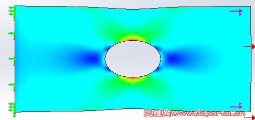

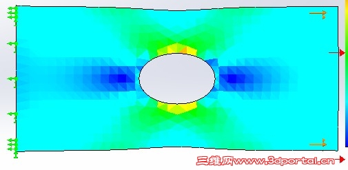

节点值:
' |7 c8 B7 H  _: T) @9 J( L单元值:& `; S6 ^5 J( R7 {: @
